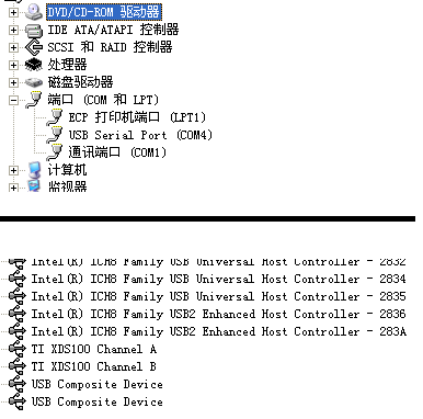

4. populate J9 on the main board, and then plug in the usb connection b.w. the controlcard and PC, it seemed succeeded in setting the COM.

Can anyone tell me how to solve this please, is the configurations wrong? or some problems of PC or the controlcard?
Thanks a lot !
