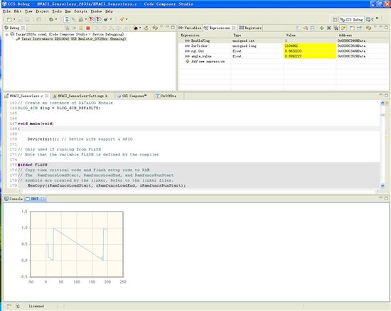

  • Dear Dorbrin
           May I ask you some question about GUI composer?
    Now I use TMS320F28335 for a motor control experiment. During the debug process, I need to observe 8 variables at same time. Originally I use DCA7714 to observe the variable. I transfer the variable through SPI communication to DA and observe them by a scope. Then I could record and analyze. However the scope only has 4 channels. But now I need observe 8 variables. So I wonder whether I could use linegraph widget to finish my task.
    This task has real-time request. The 8 variables are floating point and they are refreshed at 10KHz, which is also the frequency of Main ISR. (interrupt void MainISR(void))
    I feel TMS320F28335 use JTAG connection. But I don’t know whether it is fast enough to transfer 8 floating point variables.
    Another problem is I encounter failure when I use ScalarGraph widget.
    First I try display only one variable. I utilize a project designed by TI, provided in controlsuite.
    ti\controlSUITE\development_kits\HVMotorCtrl+PfcKit_v2.1\HVACI_Sensorless_2833x
    In this project I bind a global variable rg1.Out to value0 of the scalarlinegraph. This variable is expected to generate a ramp. I set the Buffer Length to 200. However when I run the project, the graph always has some glitch, which should not appear.
    When I change to another computer, it is even worse. There is no ramp curve at all. The only difference is the OS of the computer. The previous computer is Win XP. This one is Win7. The emulator is same, XDS100V2USB.
    I feel strange about this phenomenon. I don’t know what mistake I make. Have you ever meet such condition? Could I trouble you give me some suggestion?
  • Hello Xin,
    I’d like to make sure I understood your questions. Please correct me if I did not get them right?
    Question 1:
    I am using a TMS320F2833 with a JTAG connection. I want to create a GUI Composer application that have multiple Line Graphs in it.
    The amount of data that need to be transferred every second to display the information I need is:
    10,000 * 8 *sizeof(float). Let’s assume sizeof float in the hardware is 4 byte.
    Can the XDS100V2USB handle transfer rate of 300 Kilobytes per second?
    Answer:
    No. XDS100V2  does not have that much throughput. Let alone there are overheads of drawing the graphs, handing each received bytes. etc.
    In a ideal situation the transfer rate is 480 Kbits per seconds. http://processors.wiki.ti.com/index.php/XDS100#XDS100v2_Features
    So we are order of magnitude off, just by looking at pure throughput.
    Question 2:
    If I use a scalar graph the data shown is not what I expected. The graph also varies if I run the app on another computer. What went wrong?
    Answer 2:
    Scalar Graphs accumulate the value of the variable they are bound to each second and show the history of that variable over time.
    To be used property the target has to run enough time so the accumulated data that makes sense.
    In the first pictures you the target is halted. In the second picture there is no even a debug session.
    Can you provide pictures that the target is running and has been running for enough amount of time?
    Also, are you sure the values considered glitches are not the real values sampled at a specific time?
    Can you create a very simple project ( preferably on a simulator ) that demonstrate the issue?
    Dobrin
  • Dear Dobrin
           Really appreciate for your reply. I am so sorry to disturb you with some low level question.
    Question1 is right.
    I need transfer 300 kilobytes data per second.  Since XDS100V2 can’t handle so much data, whether we could have other method to realize such task? Whether xds560v2, which is produced by Spectrum Digital, could survive?
    If xds560v2 can not support either, and I still wish to observe 8 floating point variables at same time for debug, whether there is any possible solution? Could I trouble you to give me some suggestion?
    By the way I read the website you give me.
    • Support for USB High Speed (480 Mbit/s)
    It shows that XDS100V2 supports 480 Mbit/s not 480 Kbit/s. And I check on Google. The speed of USB2.0 is 480 Mbit/s.
    So if its speed reaches 480 Mbit/s, it equals to 15Mbyte/s. 15Mbyte/s=15*1024Kbyte/s=15360 Kbyte/s.
    And the transfer rate we need is 10,000 * 8 *4 byte=320Kbyte/s. So I feel if the transfer rate is really 480 Mbit/s, XDS100V2 could transfer 8 floating point variables.
    Whether the USB speed mentioned on that website doesn’t refer to the transfer rate?
    Question 2
    As you suggested, I catch some picture that the target is running. The target has run for a while, about 15 second.
    At my PC, Win XP system, the graph looks good. We could observe the ramp wave clearly, although there are still some glitches.
    However, when I run the same program at my laptop, OS is Win 7, the graph looks terribly.
    I feel strange. The program is totally same. And the hardware is also same. The only difference is that I install GUI Composer Runtime(CCSv5.4) for my laptop.
    I down load it from
    http://processors.wiki.ti.com/index.php/Category:GUI_Composer
    I don’t know whether it is the reason that my laptop can’t draw correct graph.
    And in your reply you also ask “Also, are you sure the values considered glitches are not the real values sampled at a specific time?

    1 Please allow me to explain my application.
    What I really want to do is debug my program with the graph.
    I am working on my induction motor drive experiment. My algorithm has some bug. I need debug the program while the motor is running. In the past I use DA to solve this problem. I design an analog output card with DAC7714, which has 4 output channels and can generate voltage from -10V to 10V. DAC7714 can be connected with 28335 through SPI communication. The variable can be transferred to DAC and shown as a voltage signal. Then I could record those voltage signals with oscilloscope. Based on oscillation graph I can analyze those 4 variables at the same time instance and find the bug.
    Since the refresh rate of my target is 10 KHz, SPI communication of DAC7714 is fast enough to handle 4 16-bit date. The following graph is recorded by scope.
    Oscilloscope only has 4 channels; however, I need observe 8 variables at same time. So I want to try GUI composer. I don’t know whether there is any alternate method for such real-time debug. I feel experts from TI must have better method, when they with motor drive program debug.
    My CCS version is 5.4.0.00091. The CCS installed on my PC and my laptop is same.
    Whether there is any document gives specific instruction of GUI composer.
    I search on the internet. I only find an introductory video about GUI Composer.
    http://software-dl.ti.com/dsps/dsps_public_sw/sdo_ccstudio/guicomposer/gc_intro/gc_intro.html
    And I also find a tutorial, a PPT file, which provides a step by step guide for how to create a simple GUI Composer Application.
    Both of them are from the wiki of TI.
    I am so sorry for my searching ability. I can’t find more details about widgets and how to use these widgets. Especially the LineGraph widget, I really want to find an example to show how to use LineGraph wiget.
    Furthermore you suggest we add a text box and bind it to $refresh_interval then we can control the refresh rate. May I ask how do you know this trick? In which document can we find such details?
    Please allow me to explain my test.
    I directly use a motor control program provided in controlSUITE to test the GUI composer.
    The project location is as following:
    C:\ti\controlSUITE\development_kits\HVMotorCtrl+PfcKit_v2.1\HVACI_Sensorless_2833x\
    After I import this project, I modify the head-file “HVACI_Sensorless-Settings.h”.
    #define   BUILDLEVEL LEVEL1
    It is at line 20 of this h file.
    In the main C file “HVACI_Sensorless.c”, I define a global variable
    float32 angle_value;
    I use this variable to connect to GUI graph.
    In the main interrupt function interrupt void MainISR(void), we could find level 1.
    Variable rg1.Out will generate a ramp wave. Since rg1.Out is IQ format, I give its value to the global variable angle_value, which is float format. angle_value is bound to value 0 in scalarlinegraph.
    I would like to send my program and my GUI project.

  • Ok, Xin, let’s try this:
     You want to show the user the values of eight variables over time.
     Since:
    -          the rate at which these variables are being modified is 10,000 changes per seconds
    -          the graph you showed me shows no more than 300 pixels
    -          the user cannot make sense of the data if you update the graph with rate higher than 5 times per second.
     Let’s assume three times a second is a reasonable refresh rate for the graph.
    That will give you a chance to display 3*300 = 900 samples in one second per variable.
    It looks like you can only show 9% of all data on a 300 pixel graph with rate of 3 frames per second.
    It is possible for you to modify the target to collect the variable on an array on the target.
    If you can do that ( have enough memory) you can do some preprocessing on the target:
    -          You can collect in one array element 11 samples – many be average, min or max.
    -          You can collect in one array element one sample but will know that your graph will only show continuous 9% of the data.
    So if you can modify your program and if you have enough memory to buffer data on the target, you can do your pre pressing on the target.
    If you do so, you have much better control what you are showing to the user.
    In that case you need to use LineGraph and bind to the array you buffer data on the target. Makes sure the array’s dimensions is rightly the number of pixels the graph shows.
    If you can’t modify the target program, or if you don’t have enough memory to buffer data on the target then you can use ScalarGraph.
    In ScalarGraph you bind to the original variable but you don’t really have much control how which samples will be skipped.
    The ScalarGrpah will transfer only one variable and buffer and shift the data on the graph. You cannot achieve continuous samples in this case.
    Please experiment with both options and see which fits you better.
    For the other questions:
    About finding documentation of GUI Composer – yes, there is no much yet, but the good news is that we are adding more.
    Soon we will be releasing Code Composer Studio version 6 – I’d recommend you try experimenting with GUI Composer once it is available. I’ll let you know when.
    For now don’t send me your projects – just try experimenting what I suggested today and see if you can make it work.
    BTW means 'By the way' :) - don’t worry about it.
    Dobrin
  • Dear Dobrin
    Really thank you for your guidance.
    I am sorry that I don’t express myself clearly.
    The oscillation graph, I show you in last letter, is actually a snapshot of my oscilloscope. So although it doesn’t have enough pixels, we could still have enough resolution on our scope. And our digital scope can store all the sample points and generate a CSV file. For example, the TKTRONIX scope TPS 2024 can store 2000 points. And we could also tune the time scale of the scope to adjust sample frequency. Then we can also draw wave with MATLAB, when we write a paper.
    The reason we use this method to debug.
    First, we need keep the time sequence of the signal. For example, we want to test the step response of the motor. Then we could snap the step reference signal and the response signal of the motor. These 2 signals have difference on time sequence. This time difference can be record by scope and analyzed.
    For another example, there are 8 variables in a function, and each interrupt the function will be executed. I need to observe these 8 variables and record them for a period. An important thing is that the 8 signals should have exact time sequence, they must keep pace. Then I could analyze step by step. Check in each interrupt and see whether these variables change as we expect. Even though there is only a short period can be stored, it is useful for me to find out the bug in my algorithm. I use GUI just because scope can only record 4 signals with exact time sequence. If the signals I record can’t keep exact time sequence, it doesn’t make any sense for debug.
    I really appreciate for your suggestion. And I do want to use LineGraph for a test. I believe TMS320F28335 is a powerful DSP. However I am so sorry that I don’t know how to operate. Could I trouble you give me an example that I could follow it. (Just like the PPT file, on TI wiki web site, which provides a step by step guide for how to operate.)
    By the way, we tried on another computer, which is installed with Windows 8. We also observe the variable that generate ramp wave with same program and same GUI project. However, we failed again. The graph obtained by GUI composer is full of glitches and make no sense. And I am sure the variable does generate a ramp, because I also observe it through our DA card on oscilloscope.
    I also tried as your suggestion. I add a text box and bind it to $refresh_interval then we can control the refresh rate. I changed it to 5000. There is no change either. (Full of glitches)
    The good news is when I change it to 1, the system still work. The graph refresh faster.
    I do really appreciate for you kind and warm help.
    With my best wishes for you. Really thank you.
  • Hello Xin,
    We just released Code Composer Studio version 6. Can you try your experiments with it: http://processors.wiki.ti.com/index.php/Category:Code_Composer_Studio_v6 See if all the glitches you are having exist in the new version.
    In my previous answer to you I showed you how can you achieve continuous sampling for 10% of the time or statistical sampling for the whole period. You can play with both of these strategies (provided you have enough target memory) to see what will help you debug you problem better. I don’t think there is bandwidth to have continuous sampling at the rate you desire. We already went through the numbers.
    Try playing with $refresh_interval in Code Composer Studio version 6. And do not set the refresh rate to less than 200 milliseconds. If you set it to anything less than that you are risking to flood many queues and eventually everything will be slower and you will run out of memory.
    Dobrin
  • Hello Dobrin,
    May I ask, in the CCS ver6, can I save as (extract) the data plotted in graphs in the GUI composer as a text file or something else?
    Edited on 1:08am.
    I just installed CCS6 and I find there is an export button by right clicking the graph. I will try it out tomorrow in office. Thank you!
    Barry
  • Yes, you can use the "export" context menu to log the current data shown in the graph.
    Additionally, if you want to log all data coming to the graph you can see how it can be done in this example: http://processors.wiki.ti.com/index.php/GUI_Composer/Logging_Graph_Data
    You can test all this in GUI Composer Preview mode of Code Composer Studio version 6.
    Keep in mind that GUI Composer Runtime version 6 is not posted yet. We will do that in few days.
    Dobrin
