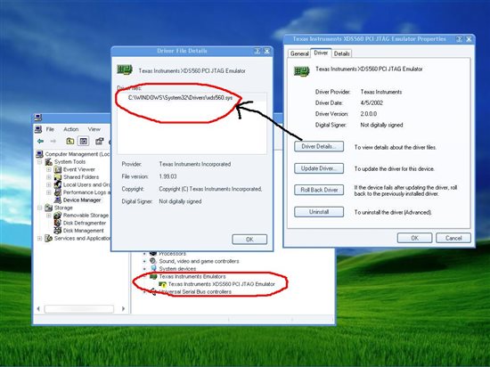

In the device manager I'm getting a yellow triangle on the tms emulator card as shown in the picture below... please help me install the correct drivers for the kit..
Just ignore the warning. You do not need the XDS560 because the TI-kits are based on the XDS100 emulator, which should be listed as USB - device.
Praveen,
There is also more about the xds560 warning here:
http://processors.wiki.ti.com/index.php/XDS100#Troubleshooting
As Frank mentioned this is an issue you can ignore for the most part..
Thank you,
Brett
Actually the problem was with the FTDI chip drivers and the code doesn't get loaded to the kit unless we install the FTDI drivers. Anyways thank you for your attention and reply Frank Bormann and Brett Larimore ...
