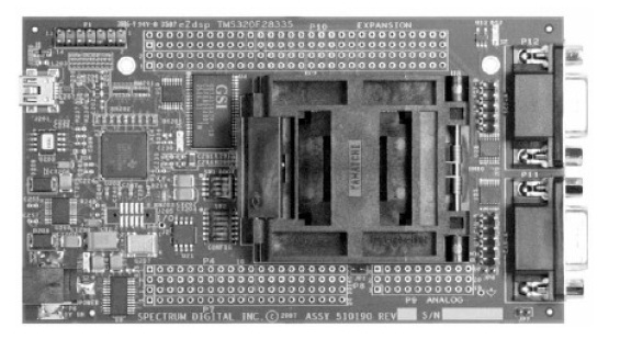

  • hi! i'm testing my network CAN with transceiver SN65HVD230 but when i tested the output voltaje of the module (connector DB9) the value in the pin 2 and 7 are 22.9 could be the problem? what i have to do if it's the problem?
    i only has a one node can i probe with them?
    Thank you
  • Hi Karol,
    You cannot operate Can module with just a single node attached on the bus. For effective communication to happen, there needs to be atleast 2 nodes on the bus.
    Vivek

  • Hi Karol,
    1. So first what you need to do is make the connections as per the comments on top of main.c. Pasting it again here for your reference.
    // Both CAN ports of the 2833x DSP need to be connected
    // to each other (via CAN transceivers)
    // eCANA is on GPIO31 (CANTXA) and
    // GPIO30 (CANRXA)
    // eCANB is on GPIO8 (CANTXB) and
    // GPIO10 (CANRXB)
    2. Then build and flash the code.
    3. To view the transmitted message, you can keep a breakpoint on the line
    loopcount++
    and view the MBOX25 register in the watch window. In the MBOX25.msgid you should see 0x95555555. In the MBOX25.MDL and MBOX25.MDH you should see ox55555555.
    Vivek
  • Hi Vivek!!
    Thank you so much for your answers, excuse me i have another questions, it is possible to connect both TMS320F28335 to computer throught the USB port? how load the program at the same time at the F28335?
    2. when you talk about these do you refers physically at the connector DB9 pin 2 and 7 CANH y CANL
    //eCANA is on GPIO31 (CANTXA) and
    // GPIO30 (CANRXA)
    // GPIO10 (CANRXB)
    3. i would like to tell you how it is my network connected
    one TMS320F28335 is connected to a computer throught the USB port, the CAN port DB9 on the F28335 is connected throuht two pins on the transceiver and the transceiver SN65HVD230 is connected to a bus throught pin 2 and 7 (pair of wires, (wire belden9841)), these one node. FOr the other node i don't know if this has to be connected in the same way, i have to open the code on the same software(code composer)?
    THank you

  • Hi Vivek,
    This is the board that i'm using, the port of CAN module it's the down connector (DB9)
    Thank you

  • Hi Vivek
    No, the DB9 connectors one of them is CAN-A the other is SCPI. you could see this document on page 87 eCAN Block Diagram and Interface Circuit.
    thank you

  • Hi Karol,
    Found it. Found the links to the ezDSP board schematics and technical refernce guide. Here's the link in case you don't have i.
    http://c2000.spectrumdigital.com/ezf28335/
    So as i see it. There are two Can tranceivers on the board.
    ECana comes on  (P11) : DB9 Connector
    ECanb comes on (J11) : Header
    So here's what you need to do.
    Step1: Link the DSP outputs to the transceiver using SW2. That is SW2, Position 1-4 must be in on position. Refer to pg 2-25 of http://c2000.spectrumdigital.com/ezf28335/docs/ezdspf28335c_techref.pdf
    Step 2: Connect the CANH and CANL on P11 and J11.
                  P11-7 to J11-4
                  P11-2 to J11-3
    Step 3: Build and flash the example i attached earlier and watch variables like i mentioned earlier on this thread.
    Hope all this helps.
    Vivek.

  • Hi Karol,
    First thing you got to understand is that there are 2 can modules in  each TMS320F28335, eCana and eCanb. These two can modules are independent to each other and they can b connected in single can bus. So instead of using 2 dsps to connect to each other, you can create a CAN network using 1 DSP only. All you have to do is connect CANHB to CANHA and CANLB to CANLA.
    Now CANHA and CANLA comes out in P11.
    CANHB and CANLB come out in J11.
    That is why you can make the connections like i said in my earlier post. This will completely avoid another dsp. Your initial testing and understanding of CAN will be easier with just 1 dsp to program.
    Vivek
