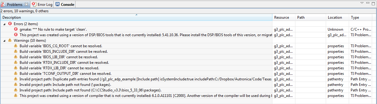

Trying to build g3_plc_adp_example from G3DevelopmentPackageV5210\F2806x\SW\TI_G3_ADP_EXAMPLE\dsp_c28x\g3\test\adp_example_project\ I get these errors.
How can I resolve them?
Hi Christian,
You need to use CCS v4.2.5 to compile the project. In addition, please install right CGT tool from C:\Texas Instruments\G3DevelopmentPackageV5210\ccs_setup\cgtools. Thank you.
Wonsoo
I have installed that CGT tool and the version stated in the error log, but is there no way to use the latest CCS? Doesn't TI have any working example for their latest development environment?
Christian,
Our upcoming release will include ADP example project on CCS v5. Thanks.
Wonsoo
Christian,
It will be available next week. Please, request the G3 ADP example via plc_support@list.ti.com. Thank you.
- Wonsoo
