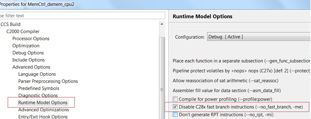

  • Hi Fabio,
    There is option under  CCS Build -> C2000 Compiler ->  Advanced Options -> Runtime Model Options, where you can disable C28x fast branch instructions.
    Following is the snapshot of the same.
    Is this the one you tried earlier?
    Vivek Singh
  • Vivek Singh said:
    Hi Fabio,
    Vivek Singh
    Hello, it was not the place I tried earlier, but activating the -me as shown above did not changed the behavior.
    Fabio
