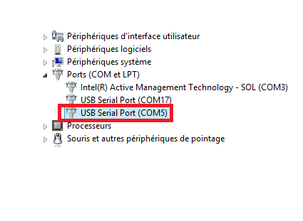

    3. Here is the snapshot of my Device Manager:
    The COM5 is the COM that I use to send and receive data to/from the Hyperterminal. The COM17 is the one of the USB/JTAG emulator.

  • Christopher Wawrzyniak said:
    COM17
    Try with this COM port.
    It should be appeared only one USB Serial Port. So I don't know why it appears two (if your already make sure that there is no other USB serial connected to your PC).
    Maria
  • Maria,
    In fact, there are two USB ports used: COM5 for serial communication and COM17 to flash the card with the USB/JTAG emulator. Should I take off the USB from USB/JTAG emulator?
    Christopher
  • You may try it and let us know what the result is.
    Maria
  • Well, I tried to take off the USB from USB/JTAG emulator but that didn't change anything.
    Christopher
  • Hello Maria,
    I found the solution! It was a problem of cable. I didn't use a null modem cable so I didn't have access to data. Now everything is correct.
    Thanks for your help!
    Christopher
