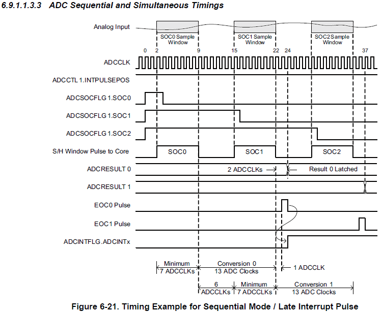

I am using Piccolo Launchpad F28027 and I want to sample analog signal at 2-3 Msps. I tried a lot of things for it but I could not exceed 750kSps at all.
Some of trials are:
Trigger with PWM and ADC ISR - Programming to RAM - has problem when buffer set huge and SCI libraries included
Trigger with PWM and ADC ISR - Programming to Flash - #pragma routine for ISR - no problem about memory but I could not be sure ISR is written on RAM, interrupt does not work with high sampling rates
ADCINT Flag controlled loop - Programming to RAM - Max sampling achieved around 750kSps
Common problem of all is that, for example when I stated PWM period to 49 (60 Mhz / 50 = 1.2 Ms should be achieved) 550-600 kSps sampling is achieved (almost half of I want).
I paste code here, modified from ADC_SOC example and added missing lines.
Both ISR and loop versions are on it.

  • One way you can sample at max speed is to do ping-pong sampling. This avoids using the epwm for triggering and interrupts for moving results to a buffer (which make it harder, but not impossible, to achieve max speed).
    Ping-pong sampling essentially sets the converter up in such a way that it will automatically convert non-stop.  You then just need to move the samples to a buffer as they are generated until you have the desired number of samples. It also uses the trick of pointing multiple SOCs to the same physical channel, such that the result registers provide some automatic buffering. I have attached some code that illustrates the idea (this is not guaranteed to compile or work without modification).  This is in the old bit-field headerfile structure, but it should be simple enough to port to the new structure.
    Let me know if this works for you.

  • Hello
    How do you get to know the sampling rate?
    Victor
  • Victor,
    With self-triggered ping-pong sampling, you would refer to the ADC timing diagrams in the datasheet to calculate the number of ADC CLKs per conversion.
    For example:
    -Tommy
  • Hello
    How were the OP get to know the sampling rate of 750ksps instead of 2-3Msps?
    Victor
