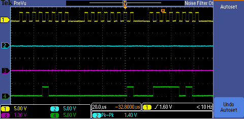

  • Hi Pradeep and TI community,
    I am also trying to use Piccolo spi for 8 bit communication. SPIB is acting as master. I have wired issue that MISO line is always high but data is pushed onto MISO line.
    Can you review below code based on your experience:

    SPI initialization
    void SPI_Init(void)
    EALLOW;
    SpibRegs.SPICCR.all =0x000F; // Reset on, rising edge, 16-bit char bits
    SpibRegs.SPICTL.all =0x000F; // Enable master mode, normal phase,
    // enable talk, and SPI int disabled.
    SpibRegs.SPIBRR =0x007F;
    SpibRegs.SPICCR.all =0x0007; // Relinquish SPI from Reset
    SpibRegs.SPIPRI.bit.FREE = 1; // Set so breakpoints don't disturb xmission
    SpibRegs.SPICCR.bit.SPISWRESET = 1;
    EDIS;
    SPI read and SPI write API
    Uint16 SPI0_Read()
    SpibRegs.SPITXBUF=(0x00<<8);
    while(SpibRegs.SPISTS.bit.INT_FLAG !=1) { }
    rdata = (Uint16)(SpibRegs.SPIRXBUF);
    rdata = (rdata>>8);
    return (rdata);
    Uint16 SPI0_Write(Uint16 data)
    Uint16 rdata;
    SpibRegs.SPITXBUF=(data<<8);
    rdata = SpibRegs.SPIRXBUF;
    Thanks for your help.
    Below is pic of output i am getting. (1 is clock, 2. is CS, 3 is MISO, and 4 is MOSI)
