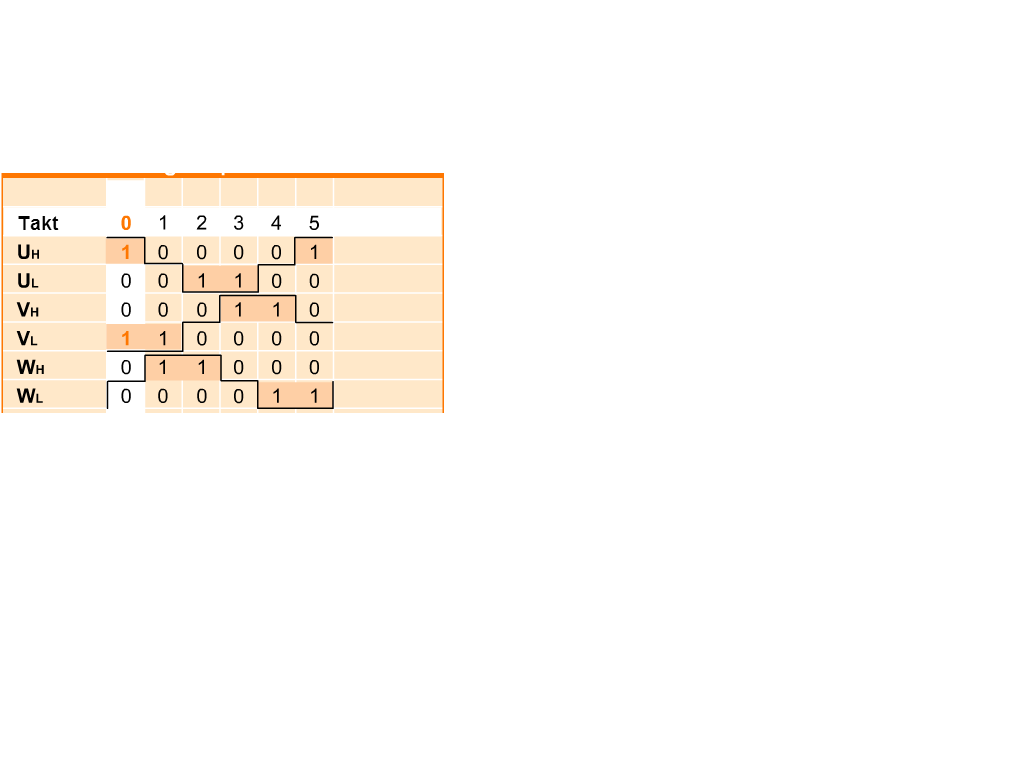

Hello everybody,
         How to  generate the following Pwm signals to run the synchronous motor(1 pole,6 commutations,3000rpm)  with  ccs v4,i ve tried more times but i didn't get,and im using TMS320F28335 processor,pls anyone can reply my problem??
Thanq u all......
  • Satish,
    I would recommend looking at the BLDC Sensored (or Sensorless) projects within controlSUITE.  The waveform that they are generating is exactly the same as the one you want to generate.
    Once controlSUITE is installed you will find these projects (and their documentation) here:
    \controlSUITE\development_kits\HVMotorCtrl+PfcKit_v2.0\HVBLDC_Sensored\
    Thank you,
    Brett
