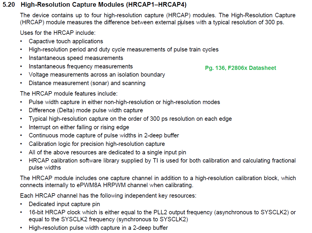

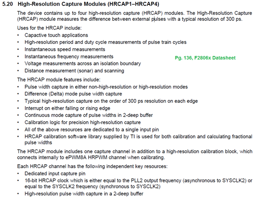

    The C2000 Piccolo family would fit your requirements well.  The peripheral I have in mind is the High Resolution Capture Module (HRCAP).  This can attain capture measurements with a resolution of 300ps using the high frequency generator.  The TMS320F2806x family will get you 90MHz CPU performance as well as this module and CAN connectivity.  It also has a floating point unit.
    I included a capture below from the F28069 datasheet (http://www.ti.com/lit/ds/symlink/tms320f28069.pdf):
    What are your cost targets?  This is a fairly loaded device, so we may be able to move to a more cost-optimized device.  The TMS320F2803x family runs at 60MHz, but will still get you the 300ps capture resolution as well as CAN, and it will be about half the cost.  The main sacrifice is losing CPU speed as well as some peripherals and CPU enhancemens (FPU for example).
