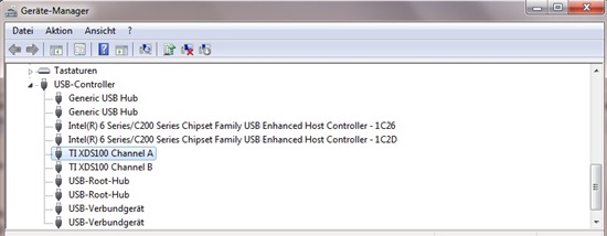

    3) It may be worthwhile to reprogram the FTDI chip and then retrying.  I've seen this get rid of Windows+FTDI issues in the past.  See the following post:
    http://e2e.ti.com/support/microcontrollers/c2000/f/171/t/21086.aspx
    4) The controlCARD (I lean this way because you tied a 5V input to a GPIO pin) or the "Docking Station" is damaged.

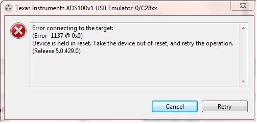

    I have tried the 1, 2, and 3 steps.  After the third step, in the device manager, the TI XDS100 Channel A and B could be found as shown in the figure
    However, when i try to connect the target agian, an error dialog pop up
    I try to disconnect the board and connet it again, the following errors are shown up
    C28xx: Error: (Error -1135 @ 0x3FF8A1) The emulator reported an error. Confirm emulator configuration and connections, reset the emulator, and retry the operation. (Release 5.0.429.0)
    C28xx: A fatal error occured while attempting to remove the remaining debug state that could not be removed at disconnect.  This might have occured because a breakpoint was set at an address that is no longer valid.  This behaviour may be turned off in the "Debug Properties" tab in the Customize dialog under the Option menu
    Does this mean i could come to the conclusion that my board is damaged? :(:(
