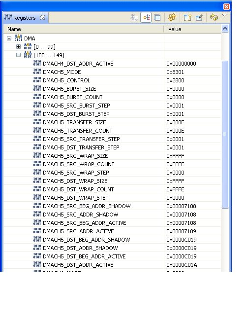

I am confused about how to a cascaded configured ADC with the DMA.  I tried all combinations of setting AdcRegs.ADCTRL2.bit.INT_ENA_SEQ1 and DmaRegs.CH5.MODE.bit.PERINTSEL. The code below shows the only configuration that allows the DMA to run somewhat, i.e. it only decrements the transfer count by 1 (from 15 to 14).  I included the DMA5 register image below.
Why isn't the DMA running to completion?

    Is any more information needed to help me with this issue.
    Stephen
    The main question is how do I set up a cascaded ADC and the DMA to transfer all 16 registers from the ADC to memory?  What am I doing wrong?

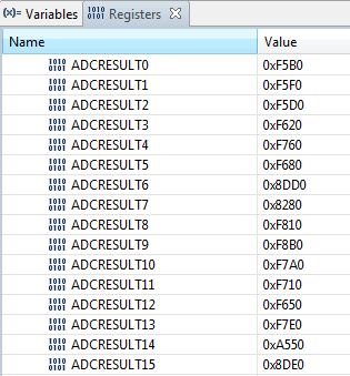

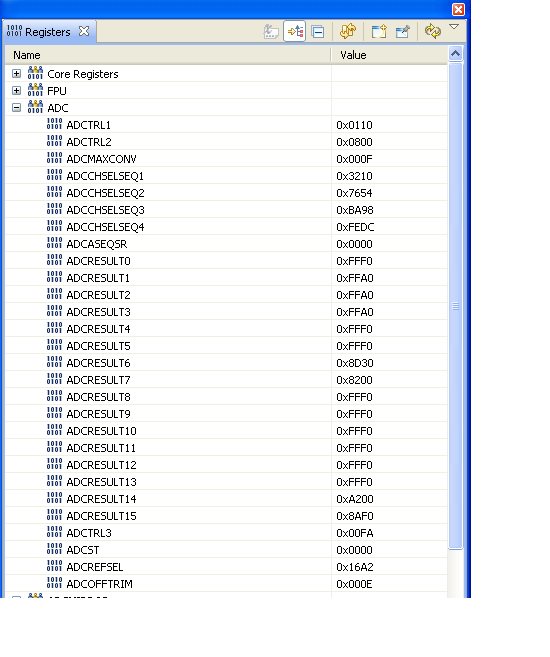

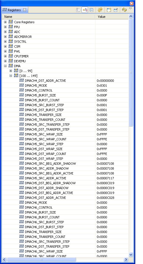

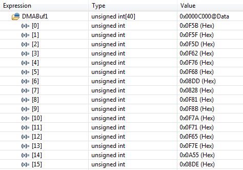

  • Ok, I fixed my code a little.
    By changing the DMA burst and transfer settings as shown below, the DMA registers show that it transferred 8 words before the DMA interrupt happens.  Shouldn't all the 16 channels get transferred?
    I also noticed that the InternalADCdata[] contains all zeros, which is different than what is show in the ADC register debug window.  I have attached both the DMA register window and the expression windows showing InternalADCdata[].
    If I change from enabling the SEQ1 interrupt to enabling the SEQ2 interrupt ( INT_ENA_SEQ2 = 1) and setting DmaRegs.CH5.MODE.bit.PERINTSEL = DMA_SEQ2INT, the DMA doesn't start the transfer.
    Can someone tell me what I am doing wrong.
    Stephen
    From:
       DmaRegs.CH5.BURST_SIZE.all = 0;     // 1 word/burst
       DmaRegs.CH5.SRC_BURST_STEP = 1;     // increment 1 16-bit addr. btwn words
       DmaRegs.CH5.DST_BURST_STEP = 1;     // increment 1 16-bit addr. btwn words
       DmaRegs.CH5.TRANSFER_SIZE = INT_ADC_NUMBER_OF_CHANNELS-1;      // Interrupt every 16 bursts/transfer
       DmaRegs.CH5.SRC_TRANSFER_STEP = 1;   // Move to next word in buffer after each word in a burst
       DmaRegs.CH5.DST_TRANSFER_STEP = 1;   // Go back to AdcRegs.ADCRESULT0
    To:
       DmaRegs.CH5.BURST_SIZE.all = INT_ADC_NUMBER_OF_CHANNELS-1;     // 1 word/burst
       DmaRegs.CH5.TRANSFER_SIZE = 0;      // Interrupt every 16 bursts/transfer
       DmaRegs.CH5.SRC_TRANSFER_STEP = 0;   // Move to next word in buffer after each word in a burst
       DmaRegs.CH5.DST_TRANSFER_STEP = 0;   // Go back to AdcRegs.ADCRESULT0

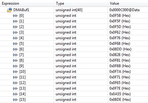

  • Stevenh,
    I have modified the ADCtoDMA example that is provided with controlSUITE and I it was successful at transferring 16 data samples. A few notes about the changes. I first changed to Cascaded Sequencer:
    AdcRegs.ADCTRL1.bit.SEQ_CASC = 1;        // 1 Cascaded Mode
    Next I added the extra conversion registers and changed max conversion for 16 conversions:
    AdcRegs.ADCCHSELSEQ1.bit.CONV00 = 0x0;
    AdcRegs.ADCCHSELSEQ1.bit.CONV01 = 0x1;
    AdcRegs.ADCCHSELSEQ1.bit.CONV02 = 0x2;
    AdcRegs.ADCCHSELSEQ1.bit.CONV03 = 0x3;
    AdcRegs.ADCCHSELSEQ2.bit.CONV04 = 0x4;
    AdcRegs.ADCCHSELSEQ2.bit.CONV05 = 0x5;
    AdcRegs.ADCCHSELSEQ2.bit.CONV06 = 0x6;
    AdcRegs.ADCCHSELSEQ2.bit.CONV07 = 0x7;
    AdcRegs.ADCCHSELSEQ3.bit.CONV08 = 0x8;
    AdcRegs.ADCCHSELSEQ3.bit.CONV09 = 0x9;
    AdcRegs.ADCCHSELSEQ3.bit.CONV10 = 0xA;
    AdcRegs.ADCCHSELSEQ3.bit.CONV11 = 0xB;
    AdcRegs.ADCCHSELSEQ4.bit.CONV12 = 0xC;
    AdcRegs.ADCCHSELSEQ4.bit.CONV13 = 0xD;
    AdcRegs.ADCCHSELSEQ4.bit.CONV14 = 0xE;
    AdcRegs.ADCCHSELSEQ4.bit.CONV15 = 0xF;
    AdcRegs.ADCMAXCONV.bit.MAX_CONV1 = 15;   // Set up ADC to perform 16 conversions for every SOC
    These were the only changes I made to the ADC configuration. For the DMA configuration, I needed to change the Burst, Transfer, and Wrap configurations:
    DMACH1BurstConfig(15,1,1);
    DMACH1TransferConfig(1,0,15);
    DMACH1WrapConfig(100,0,0,100);
    The burst config is for 16 data points and increments SRC and DEST by 1 address. The Transfer config is for 1 Burst, no increment of source, and 16 byte increment Dest. Wrap is disabled by writing a higher number than transfer.
    The last thing I changed for the DMA is when the interrupt is produced. I changed this to happen at the beginning of the Transfer:
    DMACH1ModeConfig(DMA_SEQ1INT,PERINT_ENABLE,ONESHOT_DISABLE,CONT_DISABLE,SYNC_DISABLE,SYNC_SRC, OVRFLOW_DISABLE,SIXTEEN_BIT,CHINT_BEGIN,CHINT_ENABLE);
    With this configuration you can free run and you will halt at the ESTOP command in the DMA interrupt. You can then compare ADC Result Regs with DMABuf1 and you will see that the transfer occurred. I have included those screenshots below. Also below is the Example_2833xAdcToDMA.c file. You can use this to test in the adctodma example provided in the C:\ti\controlSUITE\device_support\f2833x directory of controlSUITE.

  • Here are the screenshots.

  • Thanks Tim,
    After looking at your attached c file and playing around with my project, I was able to get it to work if I only change &AdcRegs.ADCRESULT0 to &AdcMirror.ADCRESULT0 in my project.
    It looks like there's an issue with the DMA using the ADC Peripheral Frame 2.  Is it because of the wait states?
    Stephen

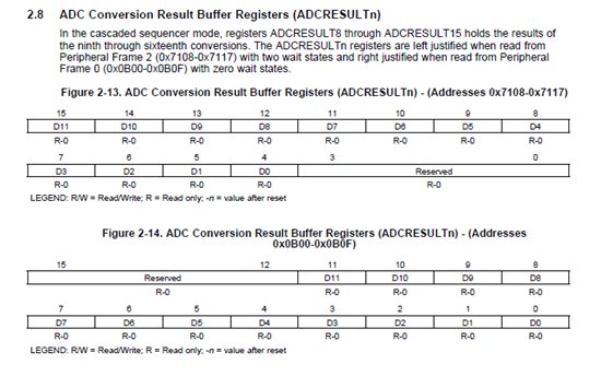

  • Stephen,
    You are correct that there is an issue with accessing the registers in Peripheral Frame 2. Internally, the registers that are accessible by the DMA are contained in Peripheral Frame 0. You can see the following information on page 32 of the ADC Reference Guide (SPRU812):
    The ADC result registers located in peripheral frame 0 (0x0B00 – 0x0B0F) are accessible by the DMA unit on the F2833x.
    Tim Love

  • Thanks.  prior to seeing your code I actually didn't realize there were two buffers locations.
    Stephen
