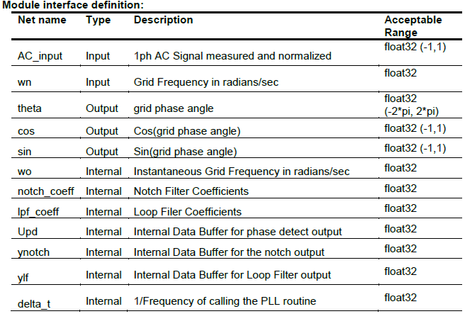

3. Figure 2. Module interface definition.
   Accepthable Range of theta is float32(-2*pi ~ 2*pi). but theta range of Figure1 is 0 ~ 0.474.
   My opinion:
     theta range of Figure1 :  maybe 0 ~ 2*pi.  Is this correct?
