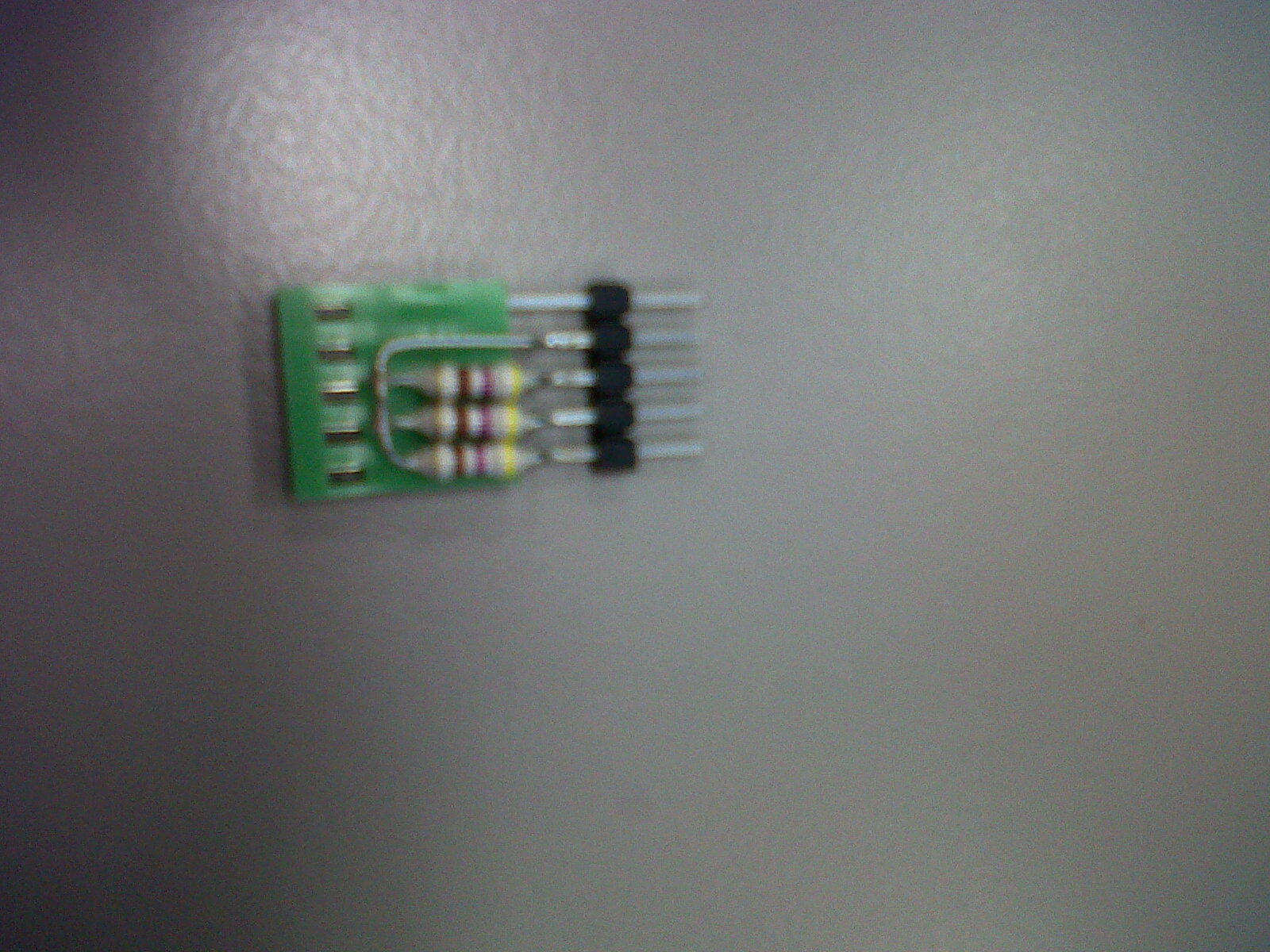

  • Hello Uwe,
    I think you use the drv8301 board.
    On this board we have a level shifter from 3,3V to 5V. To drive a pin on this level shifter you need 2mA+, and this is too much for the encoder to pullup.
    On the board we have 1k pullup resistors, these are on the limit of what will work, I would recommend you to put maybe 470 Ohm pullup resistors.
    To quickly test this try and build a connector as you can see attached, I have with success used the connector to get the QEP signals.
    Could you try and build such a pullup circuit and see if this helps with your signals from the encoder, and give some feedback on the result.
    Kind Regards,
    Kristen
  • Hello Kristen,
    the Encoder is able to deliver up to 70mA. The levels are 0.23V for Low and 5.1V for High - it should be ok. gMotorVars.EstState changes the value from EST_State_Idle, EST_State_Rs to EST_State_Online - but I could not feel any vibrations.
    Uwe
