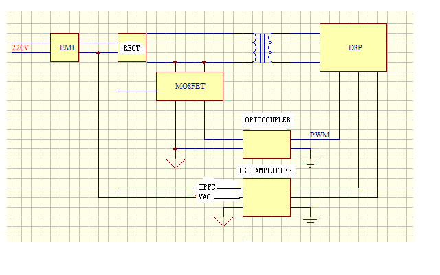

now i want to design A digital power supply; in my app ,i use one DSP to control PFC circuit and switch power circuit , the power for dsp is come from the auxiliary power supply is +3.3v and GND ; but the reference ground for Signal about the pfc (current and volt) is 0V ;so those two reference ground GND and 0v are not the same ,i want to use Optocoupler. is it right ?can it Realization?
