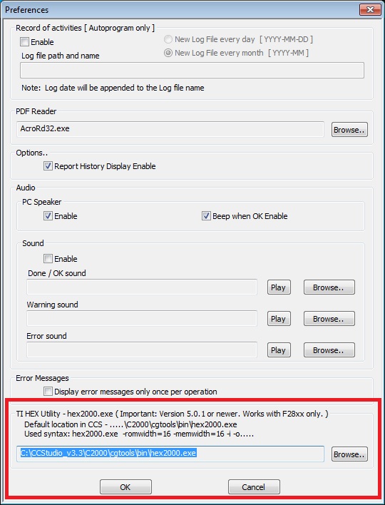

following with this issue, I need to generate a .hex file from the .out file. Using the hex2000.exe utility, I convert the out file into 2 files: .a01 and .a00, but I really need an hex file.
To get this file I've written hex2000.exe -a filename.out in the Windows MS-DOS prompt. There is something wrong?
Hi Masky,
As stated in the C2k assembly language user's guid,e page 260. http://www.ti.com/lit/ug/spru513e/spru513e.pdf hex2000 utility has a couple of options.
You may want to try this: hex2000.exe -romwidth=16 -memwidth=16 -i masky.out -o masky.hex
On the other side you can also set your path to hex2000.exe in Elprotronic programmer and it will automatically call the conversion utility with the proper parameters for you.
FlashPro2000->Setup->Preferences
I hope this helps,
With best regards
Tomas
Thank you Tomas, I can generate the hex file in the windows prompt, but... Could I do this into CCS? I checked through Menu --> project --> Buiil Option --> General tab --> Final build steps --> and written hex2000.exe -romwidth=16 -memwidth=16 -i operador.out -o masky.hex
