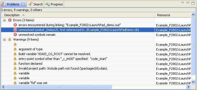

    David thank you for your explanation... I have found DelayUS function, it is hardcoded for 60MHz that i use... I'm trying to use this function but i have some problems when i compile it...
    I have added
    extern void DelayUs(Uint16);
    before main and i have copied this file in my project and now i'm getting some strange errors on picture...
    Can you help me with including this function to my project???
    Thanks...
  • Ivan,
    The function name is DelayUs().  The error message is indicating DelayUS() is unresolved.  It looks like you have a captialization error in your code someplace where you called the function.
    David
  • David,
    thank you so much, i have one function call al DelayUS instead DelayUs...  :)
