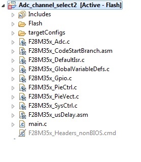

I have some problems with my Linker command file. I’m working with the H52C1 Concerto controlCARD and
I’m using Code Composer Studio 5.4. After I finish with the programs configuration,
the file i put as Linker command looks like this:
And my program doesn't work as it should because my memory is not mapped. I tried making a new project, but the same thing happens.
It worked since today, but i have no idea what happened, so if you can please help me,
I will be really grateful .

    There is not the main linker command file at your screen shot. Only excluded F28M35x_Headers_nonBIOS.cmd is presented. At Project's properties of CCS you can choose the following linker configurations (Properties->General->Linker Command File):
    - RAM.CMD for 28x core or M3 core;
    - Flash.CMD for 28x core or M3 core;
