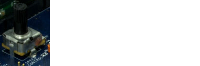

  • Hello Chris ,
    I am identifying an E bike motor , identification and tuning process is completely done and the speed controllers work exactly well. An i really feel this is a great innovation by TI which helps the user.
    And as we know E-bike will have an accelarator . so i have thought for the further utilization we can connect the accelarator to the board . So i just need an information, what is the use of the given speed control knob on the drv8301 board ?
    Thank you in advance
    Archana
  • The POT is connected to ADCB0 of the DIMM interface. So you can add code to sample this pin and translate into a speed command.
    BTW - most E-Bikes and scooters are just sending a torque command to the motor controller.  The speed is controlled by the rider commanding the torque (through pedals or a throttle), just like a passenger car.  Speed control would only be used for a "cruise control" feature.  Are you doing something different?
    Very glad to see that you are happy with InstaSPIN-FOC!
