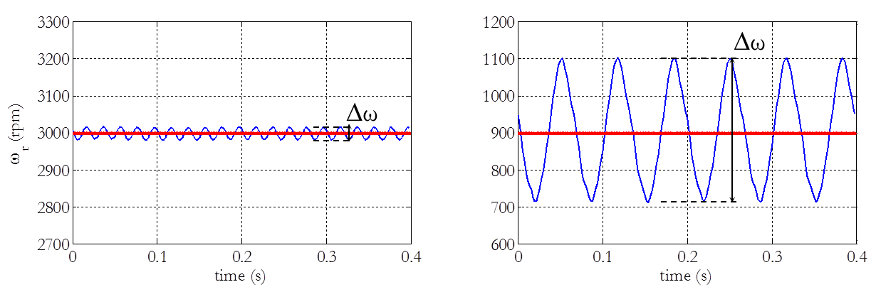

  • Hi Chris,
    Now, I am developing PMSM sensorless drive using HVPM_Sencorless from ControlSuite. I use eSMO library (level 7) for speed control.
    In the beginning, I use 2kW PMSM and it seems the controller works very well even at full speed (2000rpm) and full load condition (9.55Nm).
    However, when I want to implement to compressor, It have huge vibration at low speed(900rpm/30Hz). Although, It runs well at high speed (3000rpm/100Hz).
    As shown in the picture above, speed ripple at low speed is very big compared to high speed. I know the compressor have high dynamic load. I try a torque compensation method which estimate the load based on torque equation,
    TL = Tem - J dw/dt
    And use this TL as a feedforward compensation to Iq controller. It seems this method doesn't show significant result to reduce speed ripple. Modify PI gain didn't really help as well.
    Do you have any idea to overcome high dynamic load of compressor?
    Luiz

  • Hi Luiz,
    The vibration is for the periodic load changing of comprassor as you said, especially with heavy load at low speed.
    The most effictive way is torque compensation, you need to know the load torque curve first, and add torque feedforward control for Iq controller based on load curve and rotor position angle. Tuning speed and Iq PI regulator Kp&Ki may has some improvement for low speed with light load.
