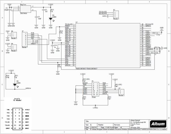

              I made my own board using the tms320f28027 (following the controlstick squematics). I'm using the Code Composer Studio version 3.3.81.28. I followed the instructions that came with the xds100v1 from spectrum digital to be able to use the emulator with Code Composer Studio 3.3.81.28. When I try to connect my board to CCS this error shows up:

    Your hardware setup is not clear to me.  Which of these options are true:
    1) The setup that is not working consists of a custom-made board with an xds100v1 emulator embedded on it (which was copied from the Piccolo controlSTICK reference)
    2) The setup that is not working consists of a custom-made board with a JTAG header on it.  I am trying to connect to the device on this board using a XDS100v1 emulator from Spectrum Digital.  This is not working.
    (feel free to describe your hardware setup if both options are wrong :) )

  • Brett,
                   I'm using the option 2.
    my schematics:
    Gastón

  • Gaston,
    From a hardware standpoint, everything appears to be valid (however for extra stability I might recommend making R10 a bit stronger, maybe ~4K7 ohm).  Obviously things work reasonably well though (since everything works in CCSv5).
    Since the controlSTICK works with CCSv3.3 (and it has an xds100v1 on-board) and your board works with CCSv5, the issue must be an incompatibility between CCSv3.3 and Spectrum Digital's xds100v1 emulator.  I might recommend that you contact Spectrum Digital for this. You could also make a post in the CCS forum.

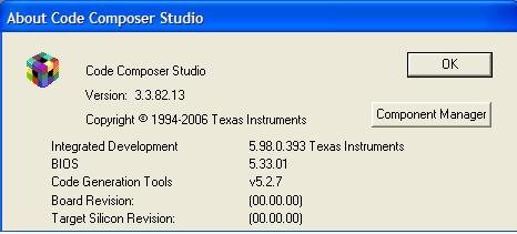

              I downloaded the SR12_CCS_v3.3_SR_3.3.82.13.exe and installed but the same error appears in the screen. Could you check if this revision is working on limited versions of CCS? I changed the f2807 of the controlSTICK (REV0) for another f28027 (REVA) and when I tried to program the Flash an error appears on CCSv3.3 screen
    FLASH API Error #1
    Unknow error during Flash operation
    This is getting darker and darker....
