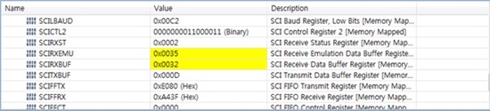

I'm using C2000 launchpad. And trying to use Bluetooth module with SCI(UART) communication.
Before use the Bluetooth module, I did a test by Hyper terminal.
I find that Launchpad Tx function works well. But Rx is not.
As below SCIRXEMU & SCIRXBUF works properly.
But the SCIRXST (Receive ready flag) never changes.
I’m using
SCI_putDataBlocking()
SCI_getDataBlocking()
In the
C:\ti\controlSUITE\development_kits\C2000_LaunchPad\f2802x_common\include\sci.h
C:\ti\controlSUITE\development_kits\C2000_LaunchPad\f2802x_common\source\sci.c
What should I do?

  • I read it. But I can't know the controller.
    However, I can clarify the problem.
    By the Guide,
    RXRDY should set when SCIRXBUF get a data. But my code doesn't work that.
    This is why I'm very confused. Can you give me some advice?
    Hwang.

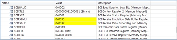

  • I don't use the BM yet.
    I'm testing board's SCI(UART) function by PC(hyper terminal).
    The board can Tx data well. But Rx is not.
    I can observe the SCIRXBUF get the right data.
    But RXRDY never sets.
    In other words, Tx works well but Rx is not. In this case, the baudrate can be problem?
    Sorry to bother you.
    But I can't understand this problem.
    Hwang

  • Thank you very much.
    Now it works fine.
    I have changed my code like yours,
    this
    test[j] = SCI_getDataBlocking(mySci);
    to
    while(SCI_getRxFifoStatus(mySci) < SCI_FifoStatus_1_Word){
    test[j] = SCI_getData(mySci);
    Thanks your help.
    Hwang
