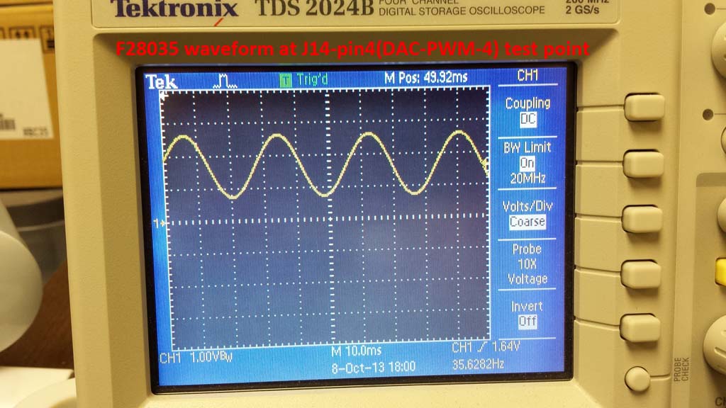

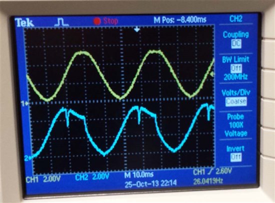

  • Chris,
    I have done the code porting from F28035 to F28069 based on HVMotorCtrl+PfcKit_v2.0 HVACI\HVACI_Sensorless code, however, I found the F28069 output waveform at HVMotorCtrl+PfcKit_v2.0 J14-pin4 (DAC-PWM-4) test point is not as good as the output of F28035 when I run LEVEL1 built code. I am using fixed point for F28069 now.
    Please see attached waveform photos. Could you please help me figure out this issue?
    Thanks a lot.
    Biao
    Figure 1. F28069 output waveform at J14-Pin4 (DAC-PWM-4) test point
    Figure 2. F28035 output waveform at J14-Pin4 (DAC-PWM-4) test point
  • certainly not a waveform you want to see!
    I've passed this along to someone else, hopefully they can help. my first instinct is to look at the set-up for the clocking and ePWM module.

  • Biao,
    Can you verify other pins in that header. They should be clean sine waves. Can you post those waveforms as well.
    Also, It will help if you can review the code for LEVEL1. There is not much intelligence  in the code other than to use SVM to generate three phase duty cycles.

  • Hi Ramesh,
    No. They are not clean sine waves. Thanks.
    Biao
  • Actually you are supposed to see third harmonic injected sine waves, with a dip at the peaks (like a dimple).
    Can you tweak the code to plot ipark1.Sine and ipark1.Cosine. If you dont get clean sine waves, then I suspect sine wave LUT is not aligning properly.
    rgds,
    ramesh
  • Ramesh,
    The third harmonic injected sine-wave outputs are not correct. Please see below picture.
    Could you or other Ti engineers do some tests on the HVMotorCtrl+PfcKit with F28069 stick card? I really need Ti's help to figure out this issue as soon as possible since I will demo my VFD prototype to my customer on 11/5/13. This is the only issue I have so far.
    Thanks a lot.
    Biao

  • Biao,
    In the code snippet below,
     pwmdac1.MfuncC1 = svgen1.Ta;
        pwmdac1.MfuncC2 = svgen1.Tb;
        PWMDAC_MACRO(6,pwmdac1)         // PWMDAC 6A, 6B
    replace svgen1.Ta and .Tb with ipark1.Sine and .Cosine respectively.
    rgds,
    ramesh
  • Hi Ramesh,
    Please see below waveforms. The top one is ipark1.Sine, and the bottom one is ipark1.Cosine. Thanks.
    Biao
  • Biao,
    Can you confirm you have a standard F28069 device and NOT an F28069M or 69F?
    It seems there is bad data from the expected location of the look up table. Perhaps it is still linking in the memory address from the x35 instead of the x69 device. That seems most likely.
  • Chris,
    The P/N is TMS320F28069PZT, which is not 69M or 69F.
    I agree with you. It is probably caused by the look up table, which is still linked to x35 memory address. Could you please let me know how to link it to x69 device.
    Thanks.
    Biao
