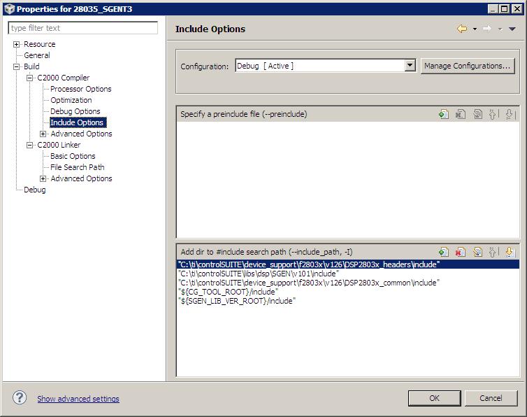

    Error comming like this "could not open source file ".

  • Hi Anil!
    Check please "Include path" and "File Search Path" project's options carefully and set these options according your paths on hard disk. There are no other problems (at least with compiling) except incorrect paths for your PC. This project is compiled successfully on my PC. I have no reason to mislead you. I believe you will cope with this task.
    Igor

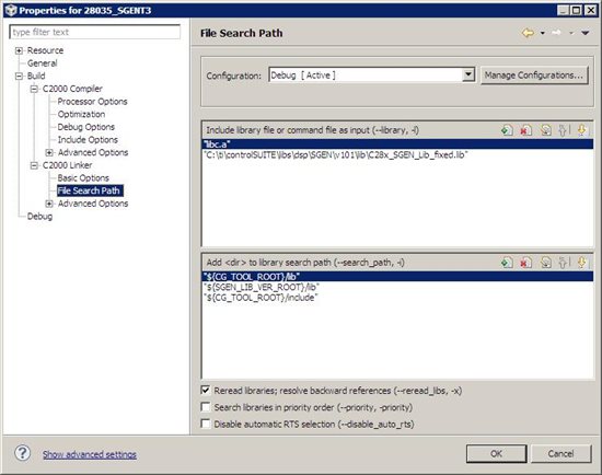

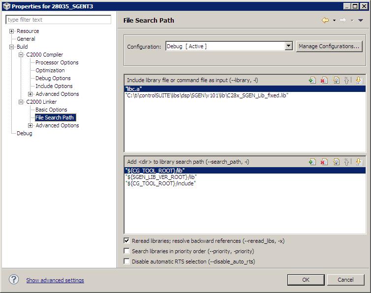

  • Igor, you are really helping, still more help.
    Anil,
    See the settings below to match 035 controller. Folder version may be different in your installation.
  • Thanks, Joy.
    Well what can I do about it? Unfortunately correcting include paths is first problem which beginners face to...Most recently, I myself was the same.
    Igor
