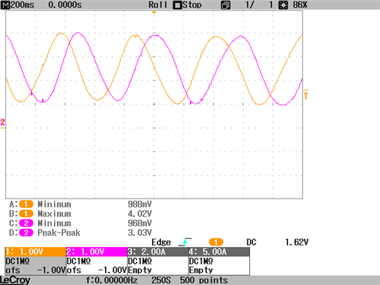

  • Hi Brett,
    you seem to be right with your Sin/Cos encoder. Unfortunatly, I'm still having some issues here.

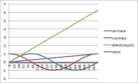

    I read the ADC values for the sin and cos trace and normalize both of them from -1... 1. This is working. Then my idea simply was to use the _IQatan2 function. Afterwards I add 2*PI to the result when the sine value is <0 to get a atan2 "ramp" from 0 to 2*PI. Then normalization with division by 2PI.
    This is my current approach (you will find some rudiments from the resolver module ;-):
    Tmp1 = _IQatan2(v->CosIn,v->SinIn);
    // add 2*Pi if angle > 180° (= negative sine value)
    if(v->SinIn < _IQ(0.0))
      Tmp1 += _IQ(6.28318);
    // Normalize from 0 (=0°) to 1 (=359°)
    v->OutputTheta = _IQdiv(Tmp1,_IQ(6.28318));
    However I don't get a correct value for Tmp1. It's always in the dimension of 10^38. Can this be a data type issue? I tried this in Excel to see if my idea would work (theoretically).
    Can you help me in this case?

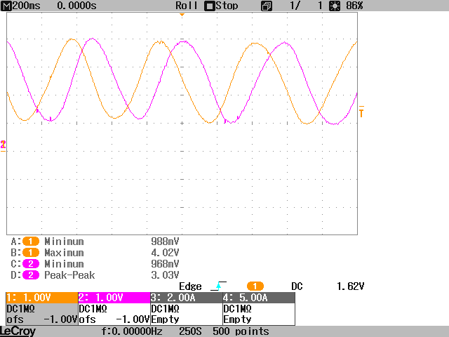

    Here is a screenshot of the original signals. They are halved before beeing fed into the DSP with an ohmic voltage divider.
    Thanks so far!
  • Philipp,
    I think the issue is a data-type kind of issue.
    What is the data-type of CosIn, SinIn and Tmp1?  Ideally, these will be of some IQ type and should match.  Your task will then be to use the proper IQ atan function (_IQNxxx() or _IQNxxxPU(), where "xxx" is the Function Name & "N" is the Q format of the input/output).
    If this doesn't make sense, I would recommend taking a look at the IQmath_Quickstart.pdf guide found in controlSUITE at the following approximate directory:
    \controlSUITE\libs\math\IQmath\v160\doc\
    Thank you,
    Brett
  • Hi Brett,
    I just had a quick look into the IQmath manual and found the solution... I changed the function parameters for the atan2-function.
    It's finally working as I expected:
    /* Arctan2 Function (this is where the mistake was) */
    v.Tmp1 = _IQatan2(v.SinIn,v.CosIn);
    /* Add 2*PI for angle > 180° */
    if(v.SinIn < _IQ(0.0))
      v.Tmp1 += _IQ(6.28318);
    /* Some low-pass filtering */
    v.FilterGain = _IQ(0.95);
    v.FilterTheta = _IQmpy(v.FilterGain,v.FilterTheta) + _IQmpy((_IQ(1)-v.FilterGain),v.Tmp1);
    /* Normalize from 0 (=0°) to 1 (=359°) */
    v.OutputTheta = _IQdiv(v.FilterTheta,_IQ(6.28318));
    Tmp1, SinIn and CosIn are IQ values.
    Thanks for the suggested solutions! Until next time!
