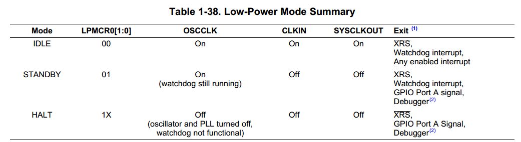

    Hi, you won't be able to wake it up from idle mode using GPIO! Here's why:
    Use XRS or a Watchdog interrupt for IDLE condition. Also please go through "1.3.3 Low-Power Modes Block" in SPRUH18D document named F2806x Technical Reference Manual.
    Gautam
  • Hi Louis! (Hi Gautam)
    From above Table it follows you can use  "any enabled interrupt". Thus you need to associate GPIO12 with one from external interrupts XINT1/XINT2/XINT3. How to do it you can look at example here ti\controlSUITE\device_support\f2806x\v136\F2806x_examples_ccsv5\external_interrupt\.
    Igor

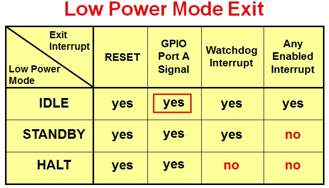

  • Thank you, Gautam abd Igor, for your timely instructions. That really helps.
    I was misled by TI's Multi-Day Training material, C28x_Microcontroller_MDW_4.0, seen on both pdf (p. 5-15) and ppt (slide 30).
    Correct technical documentation is so important!
