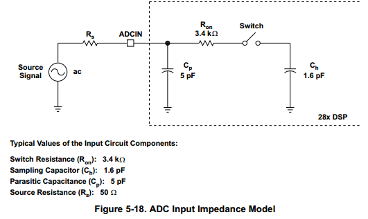

  • Hi David,
    I just realize that also. I have a ControlSTICK F28069 and I programmed it with the ContinuousADC example from ControlSUITE. I am measuring values around 1320 on all inputs with the pins floating. However, if I put a 1 kohm to ground on one of the inputs (in this case A2), I still measure approx. 1220 on A2 but the values on other inputs also change (e.g. A5 becomes approx. 700 and A6 becomes approx. 850).
    Question is: if I have a resistive voltage divider (say R1 between the voltage to be measured and the ADC pin and R2 between ADC pin and ground), which values should be used to guarantee small error? On C2000 DPS Workshop EVM the values are R1 = 680 and R2 = 330. On my custom board I selected, before knowing that, R1 = 316k and R2 = 100k.
    Alberto

  • Thank you Gautam,
    The concept of the voltage divider is clear. What was not so clear was how much current the MCU sinks/sources. I thought there should be a buffer inside the MCU which would make this current negligible. I does not make sense for me to put a buffer for every analog input. Nevertheless, if the current is constant or proportional to the input voltage, an in-circuit calibration might compensate it.
    Thank you for your suggestion!
    Alberto
  • What was not so clear was how much current the MCU sinks/sources
    The source/sink currents are 4mA
    Gautam
  • Alberto,
    The leakage current for the ADC pins is +/-2uA.
    You can use this, along with the ADC input model (see below), and the model of your driver circuit to simulate the settling accuracy.
    Assume that Ch starts uncharged and you would like it to charge to the desired accuracy (typically 0.5 LSBs or 0.25 LSBs of the final value, but you can accept less settling to loosen the requirements on driving circuit).  The switch will be closed for the S+H duration.  By default, this is probably 7 ADCCLK cycles, or 156ns, but you can increase the ACQPS setting to allow more settling time.  It is also possible to add a large capacitor in parallel with Cp so that this capacitor charges while the ADC is not sampling this channel, but when the switch opens the external capacitor (and Cp) charge Ch directly (this is called charge sharing, see this app note http://www.ti.com/lit/an/spna061/spna061.pdf).
  • To clarify a little:
    When simulating, you would replace the AC source and 50ohm resistance with your driving circuit (in your case a voltage divider).
