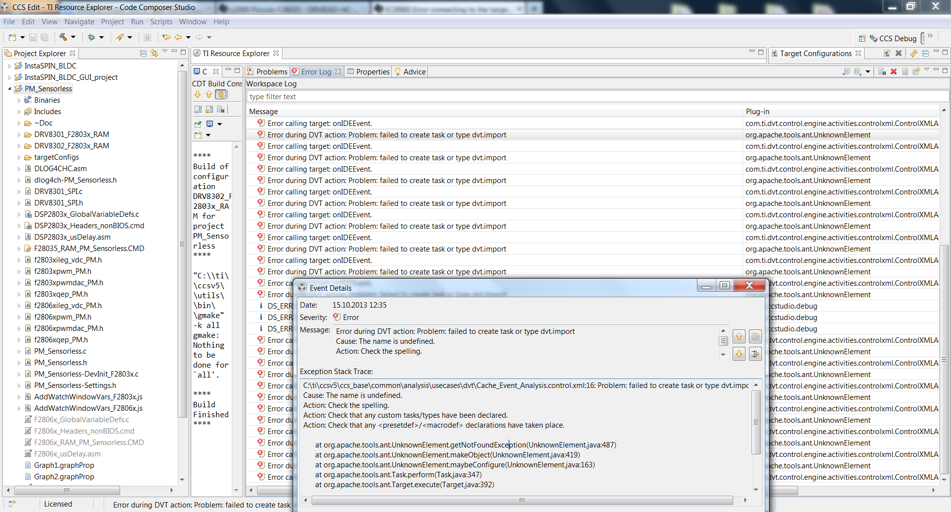

1) When I build the PM_Sensorless project, it gives a warning, which is "warning: build attribute vendor section TI missing in".
I think I can ignore it but when I debug the project, there errors occur
"Error calling target: onIDEEvent." and
"Error during DVT action: Problem: failed to create task or type dvt.import
Cause: The name is undefined.
Action: Check the spelling.
Action: Check that any custom tasks/types have been declared.
Action: Check that any <presetdef>/<macrodef> declarations have taken place.
Action: Check that any <presetdef>/<macrodef> declarations have taken place."
What should I correct to get rid of this?
