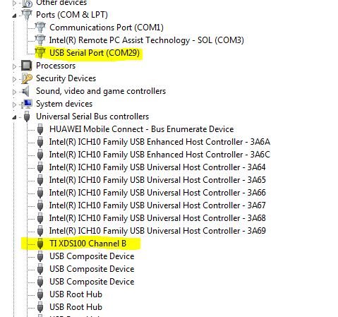

i'm using CCS 5.3 with a Tms320f28035 docking station and controlcard, with the XDS100v1.( i'm using Windows 7)
When I connect the hardware to the PC the device is automatically recognised and in the device manager  it shows as TI XDS100 Channel B and USB Serial port. (CHANNEL A doesn't show up).
And when I try to debug or click the Test connection an error connecting to target error shows up.=>
Error connecting to the target:
(Error -151 @ 0x0)
One of the FTDI driver functions used during
the connect returned bad status or an error.
It is a brand new Docking station and control card, and its perfectly working with an other laptop running windows 8.
Please help with the problem and how to debug it.
