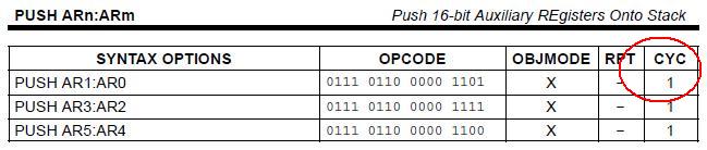

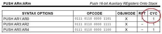

         There is a problem connected with an asembler instructions execution time in my program. As described in the "TMS320C28x CPU and Instruction Set Reference Guide" (SPRU430E), such commands as "PUSH ARn:ARm" and "MOV AX,loc16" (for example) should be execute for 1 cycle:

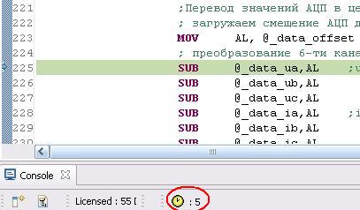

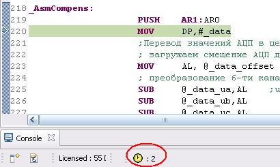

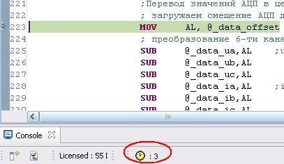

     But in practise i have  different time of execution:
       Such time differences appears not only in this commands. What is the reason for this differences?
  • Hi George!
    Values on your screenshot have a random error (+-1). In this case, I'd rather trust the documentation than the debugger.

  • These 'skid' cycles are discussed a bit in the C28x CPU users guide section 7.3. The benchmark counter is best used on chunks of code. where off by one cycle doesn't really matter, instead of small snippits.
    7.3 Benchmark Counter/Event Counter(s)
    The 40-bit performance counter on the C28x can be used as a benchmark
    counter to increment every CPU clock cycle (it can be configured not to count
    when the CPU is in the debug-halt state). Wait states affect the counter. Wait
    states in the read 1 and write pipeline phases of an executing instruction affect
    the counter, regardless of whether an instruction is being single-stepped or
    run. However, wait states in the fetch 1 pipeline phase do not affect the counter
    during single-stepping, because the cycle counting does not begin until the de-
    code 2 pipeline phase. The counter counts wait states caused by instructions
    that are fetched but not executed. In most cases, these effects cancel each
    other out. Benchmarking is best used for larger portions of code. Do not rely
    heavily on the precision of the benchmarking. (For more information about the
    pipeline, see Chapter 4.)
  • One other point - the cycles in the users guide assume the best case possible: code is in single cycle RAM and the opcodes being fetch are in a different physical memory from data being read/written by an instruction.   The memory map in the data manual shows the physical blocks of memory.
