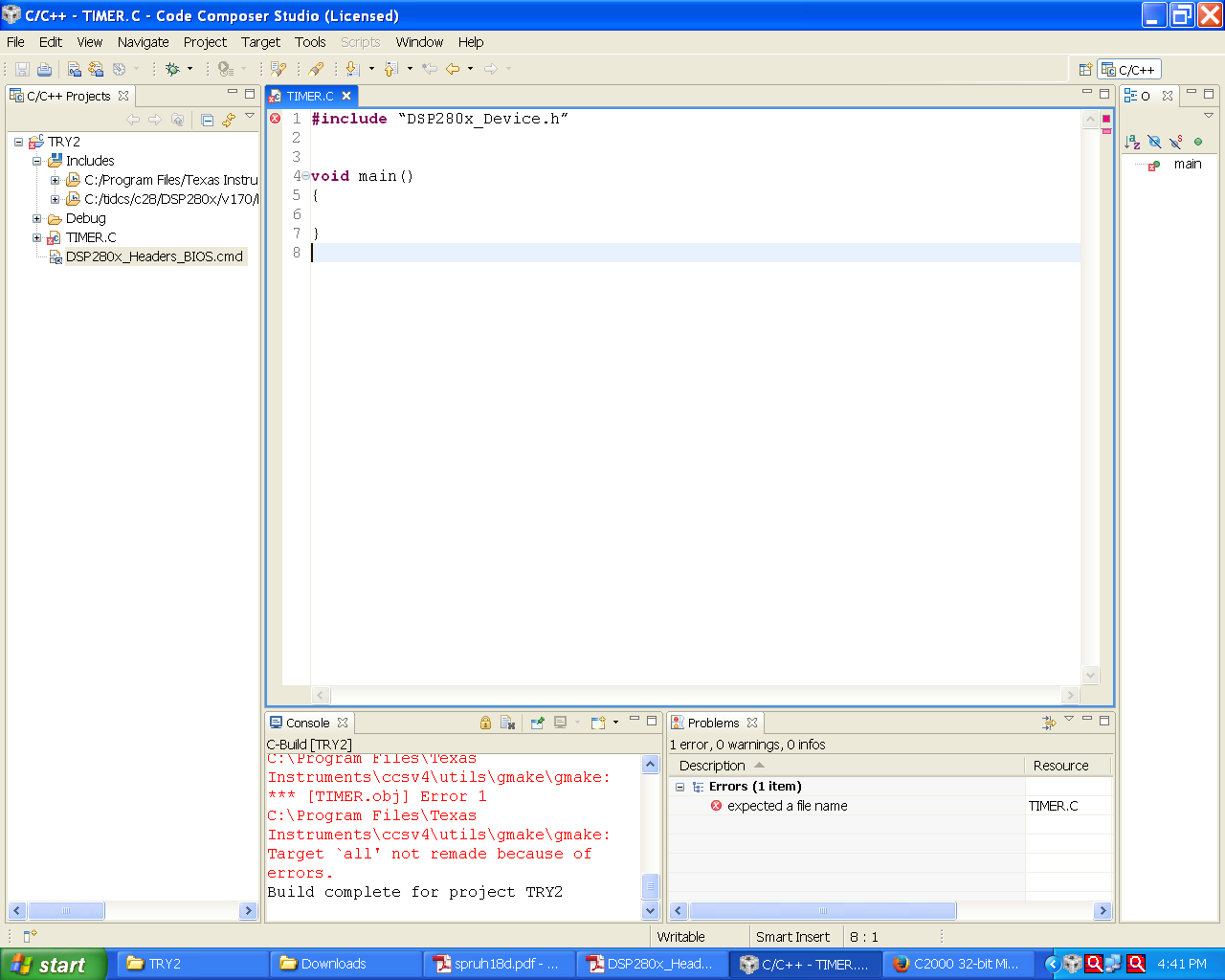

i have attached one image, can anyone please tell me what is that error.its giving expected a file name.
please help..
thank you

You're Welcome.
Do revert to the forum if you face any further issues.

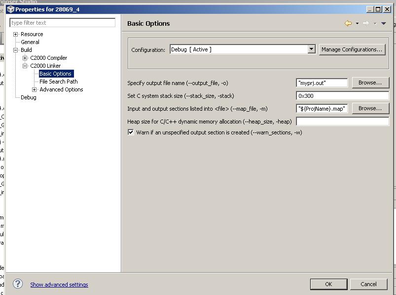

hey hello gautam :here's another issure i am facing when i am using existing project
warning: entry-point symbol other than "_c_int00" specified: "code_start"
how can i remove this.
and i have attatched one image which is showing some errors. i have read the links u send me for the previous question but i am still not getting it.plz help me with this....

Hi!
This is not error. You can don't pay attention to this warning and don't worry about it. If you want to turn off this warning, then refer to this screenshot (set please to "Suppress diagnostic": 10063)
Igor
