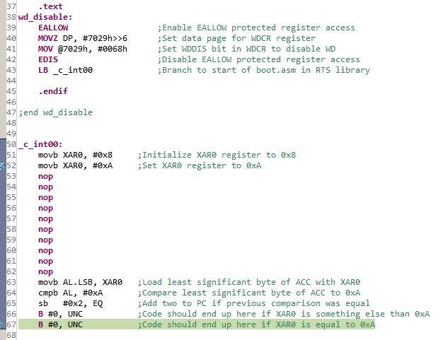

I have attached minimum working example from the problem. It is basically the standard CodeStartBranch.asm with few lines of additional code. The added few lines are:
c_int00:
00a008:   D008        MOVB         XAR0, #0x8
00a009:   D00A        MOVB         XAR0, #0xa
00a00a:   7700        NOP

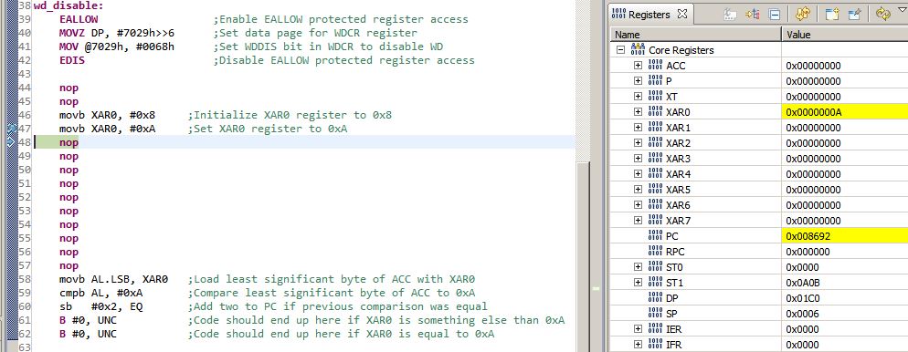

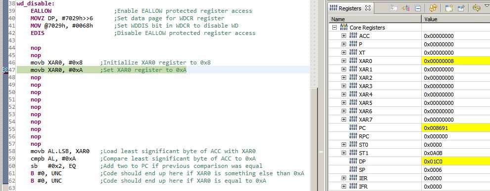

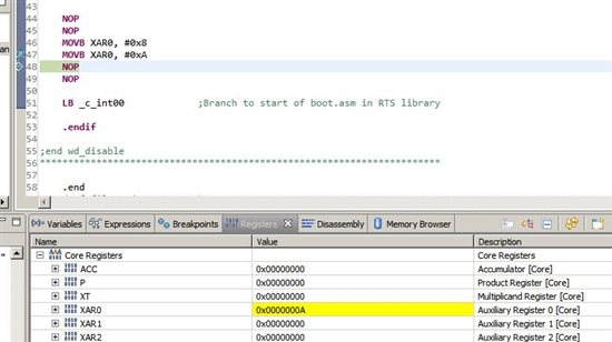

    I tested the C28346 this morning, and as I expected the breakpoints are working correctly.  I inserted your exact ASM code into my CodeStartBranch.asm file.  Here is the screen shot after hitting the breakpoint at line 47.  You can see that XAR0=0x8 in the register view:
    If you then single-step, XAR0 changes to 0xA, which is expected:

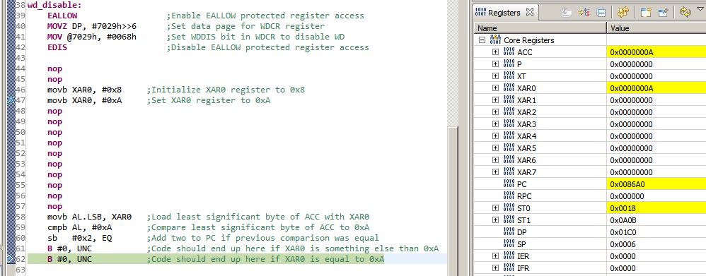

    If instead of stepping from the breakpoint, I do a RUN and then HALT, I end up at line 62.  Again, this is expected and correct:
    I am using XDS100v2 emulator same as you, and CCSv5.5.  There is no configuration option in CCS to supress execution of the instruction at a breakpoint (and such an option would make no sense since why would anyone want to do this?).  I've also tested with both HW ans SW breakpoint.  Execution is correct with either type.  There must be something else going on in your system, but what I do not know.

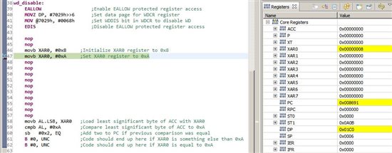

    I was able to repeat this problem with TI dev kits (TMS320F28027, TMS320F28335 and TMS320C28346). Updating CCS to newest version 5.5.0.00077 made no difference. I updated also CCS plugins and made sure that the XDS100v2 drivers were up to date. Also my colleague was able to repeat this problem on his machine.
    I was able get through with correct behavior few times and think there is some kind state involved. These are my findings:
    1. Getting correct behavior is related to free run (green triangle) of the debugger after program load. Once one has loaded program (start debugging session, connect to the target, load program) placing a breakpoint (software or hardware) in to 'movb XAR0, #0xA' and pressing free run will stop to 0xA008 in my case. Single stepping after this XAR0 will be loaded with 0xA. Behavior is correct after restarting execution using single-stepping and there is no need for free run.
    2. Wrong behavior is achieved by not using free run. Loading program (start debugging session, connect to the target, load program), placing breakpoint and single-stepping results in wrong behavior. Restarting execution and single-stepping afterwards results in wrong behavior. However, if one restarts execution and uses free run, the behavior is correct then on.

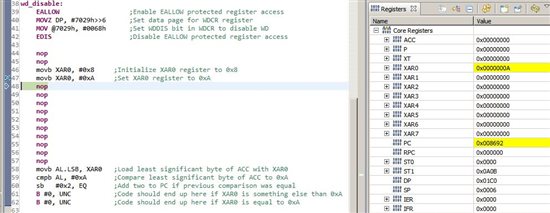

    I'm not doing anything with FREE RUN.  I believe what FREE RUN does is disable all breakpoints and then disconnects from the target. This let's the target run.  When you hit HALT, CCS reconnects, halts the processor, and re-enables the breakpoints.

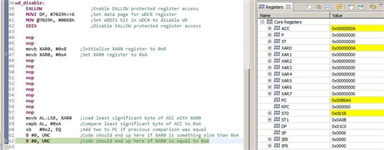

    I just tested again using CCSv5.5, F28335 and XDS100v2 (same as you).  Built the code, flashed the code, reset the processor (CCS reset), and set the breakpoint on 'movb XAR0, #0xA'.  Hit RUN, and I hit the breakpoint.  Hit RUN again, followed by HALT, and I see XAR0=0xA in the register view and the code is at the 'B #0, UNC           ;Code should end up here if XAR0 is equal to 0xA' instruction:
    The above '_c_int00' function is YOUR CODE.  I copied it from your forum post file attachment.  Note that in the above test I used a HW breakpoint because the project is running from flash.  But, I could do the same thing with a SW breakpoint in RAM and have the same results.
    I do not know what is going on with your setup.  It is even stranger that you say you see the same thing on a co-workers setup.  Believe me, CCS has been around a long time and so has the C2000.  When you set a breakpoint, it does not interfere with the execution of the instruction at the breakpoint.  It's been working correctly for a long time.  I have no doubt that something funny is going on with your setup.  I just cannot tell you what via remote support such as this forum.
