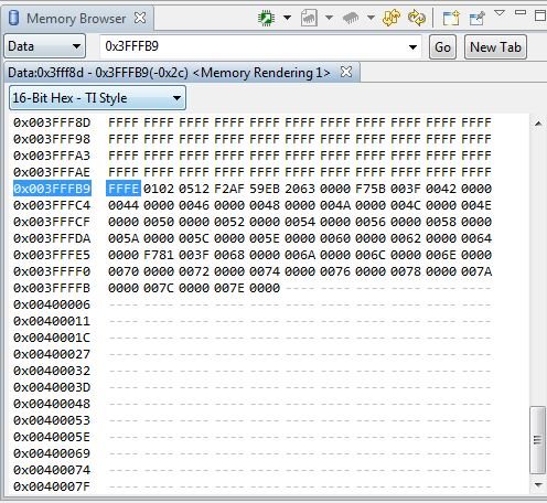

  • Could you post the bootrom version, checksum, part ID and revision for the devices that have the incorrect table entries.
    You can find that info at these locations:
    0x3F FFB9
    0x3F FFBA Boot ROM Version Number
    0x3F FFBB MM/YY of release (in decimal)
    0x3F FFBC Least significant word of checksum
    0x3F FFBD . . .
    0x3F FFBE . . .
    0x3F FFBF Most significant word of checksum

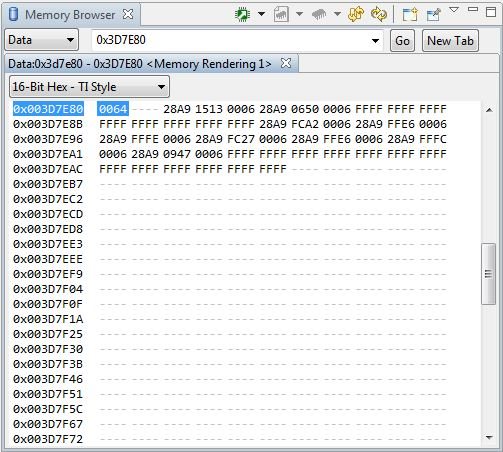

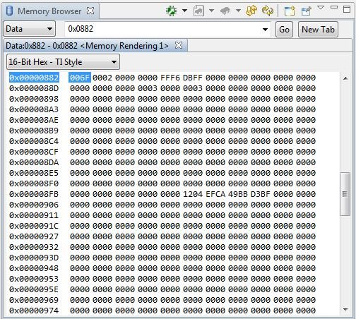

    PARTID   0x3D 7E80 1 Part ID Register
    CLASSID 0x0882       1 Class ID Register
    REVID      0x0883      1 Revision ID Register
  • Vishal,
    Thanks for the reply. Please find below a few screenshots of the memory at the requested locations:
    0x3F FFB9:
    0x3D 7E80:
    0x0882:

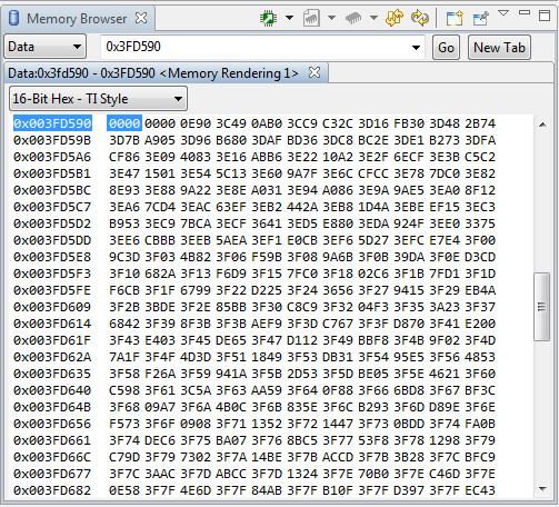

    Memory at the address where I think that the FPU ROM starts:
    Memory at the address where TI specify the FPU address to start:
    Many thanks for your help
    Will
  • How about the part numbers that are on-top of the chip's package?
    My guess is that you have
    TMS320F28062F
    devices. These are a different revision of the 6x series chip which replaces some of the regular ROM with our special ROM for InstaSPIN-FOC.  The entire ROM on these special devices is also execute only, no read access.
