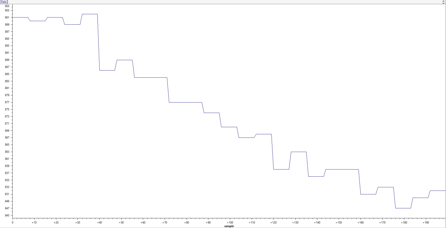

TMS320F2806 ADC duplicating sample values eight times
I have a simple polling loop in assembly called by a C application.
100MHz system clock.
SysCtrlRegs.HISPCP.all = 4; // HSPCLK = SYSCLKOUT/ADC_MODCLK   12.5 MHz (from examples)
I set up trying both single sample (0,0,0) and continuous with override (0,1,1)
I have 15 for ACQ_PS
	// Specific ADC setup for this example:
AdcRegs.ADCTRL1.all = 0x0F60;
//		AdcRegs.ADCTRL1.bit.SEQ_CASC = 0;        	// 0 not  Cascaded mode
//		AdcRegs.ADCTRL1.bit.CONT_RUN = 1;       	// Setup continuous run
//		AdcRegs.ADCTRL1.bit.SEQ_OVRD = 1;       	// Enable Sequencer override feature
//		AdcRegs.ADCTRL1.bit.ACQ_PS = ADC_SHCLK;  	// Simultaneous single-shot mode: Sample rate   = 1/[(2+2.5+ACQ_PS)*ADC clock in ns]
													// = 1/(23.5*80ns) = 1/1880ns = 532KHz (for 100 MHz devices) before ADCTRL3.ADCCLKPS
	AdcRegs.ADCTRL2.all = 0;
	//	      AdcRegs.ADCTRL2.bit.SOC_SEQ1 = 1;			// start
	//	      AdcRegs.ADCTRL2.bit.RST_SEQ1 = 1;			// stop
	AdcRegs.ADCTRL3.all = 0x00E2; //0x00E4;
	//AdcRegs.ADCTRL3.bit.ADCCLKPS = ADC_CKPS;	// 1.820 us * factor --> start with 4x (0x02)
	//AdcRegs.ADCTRL3.bit.SMODE_SEL= 0;			// simultaneously take (but ignore) B4 so we can use SOCB out pin
	AdcRegs.ADCMAXCONV.bit.MAX_CONV1 = 0x0;  // convert and store in 1 result register
	AdcRegs.ADCCHSELSEQ1.bit.CONV00 = 0x02;	// ADC channel A2
I have tried both AdcRegs and AdcMirror.
Assembler receives a pointer to array, starts ADC, waits for INT_SEQ1, clears the interrupt flag, stores the sample, and reloops for the next point.  The numbers are reasonable, but they are identical for 8 loops then change only every 8 samples.

The code behaves the same regardless of continuous mode or single-shot.
Somehow I am getting 8 identical readings followed by a jump in value.
I could accept this if the jumps between sets were on the order of the real resolution (+/- 2) but there are significant jumps.
 Assumptions:
1) HISPCP.all = 4; gives 12.5 MHz as per the examples I looked at.  Just to be sure, I divided by 8 and still see the repetition.
2) INT_ENA_SEQ1 is zero unless I want to use an ISR.  I do not.  I just want flag set on data ready.
3) INT_MOD_SEQ1 is zero - I want a flag per sample.
4) ADCCLKPS = 1 or 2 should not affect anything except sampling rate.
5) In the debugger I see the flag set and clear as I step through.  The flag is set at the end of the sequence.  I *assume* this means the conversion is ready.  Even if not, I'd assume I would get a different conversion every time, one sample late or get corrupted and nonsensical values.
6) I assume the zero wait state mirror is loaded and available at the same time as the base result, just reads faster.  Do I need to delay between the INT flag and reading the register??
  • OK, I still do not know why stopping and starting conversions was not working, but the example I posted with continuous conversios should NOT have had sequence override set.  After re^nth-reading the datasheets I see that it caused the full 8 conversion sequence to run despite MaxConv...but I kept reading the same register 8 times.
