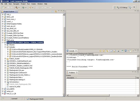

  • Hi Yngve!
    If you mean example project from folder
    ti\controlSUITE\development_kits\TemplateProjects\FlashingLeds-F28035_v1.0\
    I haven't problems with one. Perhaps you have imported it  to your CCS workspace incorrect. You need to do following: Project>Import Existing CCS Eclipse Project>Browse etc. Also at "Import Window"  fill check box "copy project into workspace". You can check a content of your project folder through my screenshot:
    Igor
