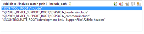

3c: Corrected all the include folders from
to
because of linking errors in the $-stuff.
