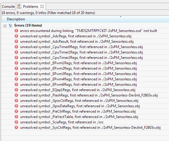

<Linking>
 undefined      first referenced
  symbol            in file
 _AdcRegs       ./2xPM_Sensorless.obj
 _AdcResult     ./2xPM_Sensorless.obj
 _CpuTimer0Regs ./2xPM_Sensorless.obj
 _CpuTimer1Regs ./2xPM_Sensorless.obj
 _CpuTimer2Regs ./2xPM_Sensorless.obj
 _EPwm1Regs     ./2xPM_Sensorless.obj
 _EPwm2Regs     ./2xPM_Sensorless.obj
 _EPwm3Regs     ./2xPM_Sensorless.obj
 _EPwm4Regs     ./2xPM_Sensorless.obj
 _EPwm6Regs     ./2xPM_Sensorless.obj
 _EQep1Regs     ./2xPM_Sensorless.obj
 _FlashRegs     ./2xPM_Sensorless-DevInit_F2803x.obj
 _GpioCtrlRegs  ./2xPM_Sensorless.obj
 _GpioDataRegs  ./2xPM_Sensorless.obj
 _PieCtrlRegs   ./2xPM_Sensorless.obj
 _PieVectTable  ./2xPM_Sensorless.obj
 _SciaRegs      ./src Crosshairs/Commros_user.obj
 _SysCtrlRegs   ./2xPM_Sensorless-DevInit_F2803x.obj
error: unresolved symbols remain
error: errors encountered during linking; "TMDS2MTRPFCKIT-2xPM_Sensorless.out"   not built

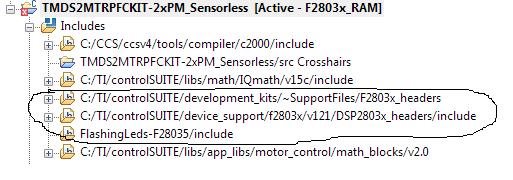

Below are some screens:

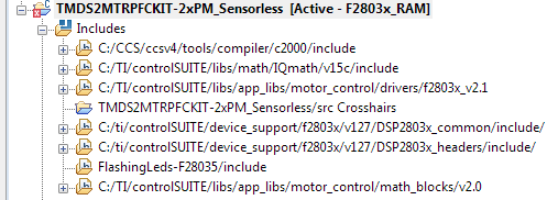

  • Yngve,
    let's look at your includes:
    Try remove from "Include options" of project properties 3 lines after "...math/IQmath/v15c...". Paste instead them the following:
    C:\ti\controlSUITE\device_support\f2803x\v127\DSP2803x_common\include\
    C:\ti\controlSUITE\device_support\f2803x\v127\DSP2803x_headers\include\
    Igor

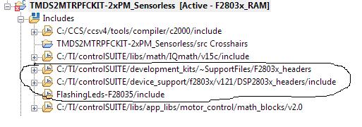

  • Hi Igor and thank you for your reply :-)
    Not quite sure what you meant, but I removed the "math/IQmath/v15c"-line from include options list and added the two others you suggested.
    The include list now looks like this:
    (Not sure why the flashing leds are there).
    I cleaned the project and rebuilt it.
    The same issues are still there along with a new one:

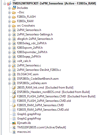

  • Thank you for your suggestion, Gautam.
    I tried replacing the existing .cmd-files with the ones from the zip file but it had no effect on the problem.
    Below is the project tree as it is configured now (with excluded files and so on)

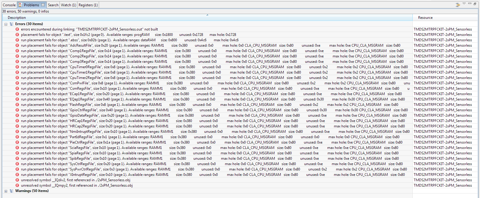

    And here is the error from the build:
    <Linking>
    "../F28035_RAM_2xPM_Sensorless.CMD", line 81: error: placement fails for object
       ".text", size 0x1fc2 (page 0).  Available ranges:
       progRAM      size: 0x1800       unused: 0x1728       max hole: 0x1728
    "../F28035_RAM_2xPM_Sensorless.CMD", line 90: error: run placement fails for
       object ".ebss", size 0x92b (page 1).  Available ranges:
       dataRAM      size: 0x800        unused: 0x4c6        max hole: 0x4c6
      symbol            in file
     __IQdiv2       ./2xPM_Sensorless.obj
     __IQmpy2       ./2xPM_Sensorless.obj
       not built
    >> Compilation failure

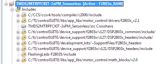

  • Yngve,
    at first let's look at unresolved symbols: IQdiv2 & IQmpy2. Restore please in "Include options" path "....math/IQmath/v15c... ". I didn't mean remove this path. I have meant remove only 3 path lines after him and add
    (you did that already but old 3 paths which I mean you didn't remove still)
    Igor
  • Hi Igor, sorry about the misunderstanding.
    I have removed the 2 lines after IQmath/v15c, but i can't find where to remove this flashingLeds-stuff. It is not listed in the include options, and it is not possible to delete directly from the project folder tree.
    I also had some missing files-problem after removing the two include-folders, but after re-adding only the required files I have now no missing symbols - only placement fails.
    Thank you very much, this is another step forward. I might actually need to connect the motors soon :)
