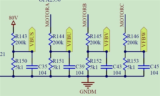

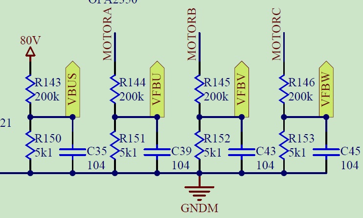

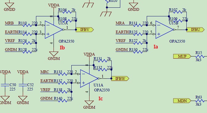

         First of all, thank you for your reply.I want to clarify some things,I'm using my own HW,reference to the Ti HW design,not the Ti HW,so I'm using Motorware not the GUI.My motor rated voltage is 80V,rated current is 5A,rated frequence is 200HZ,so I use the motorware HVKIT_REV1P1 code to drive my motor.This is my sampling circuit diagram:
                                                                         Figure1 voltage sample circuit
                                                                        Figure2 current sample circuit

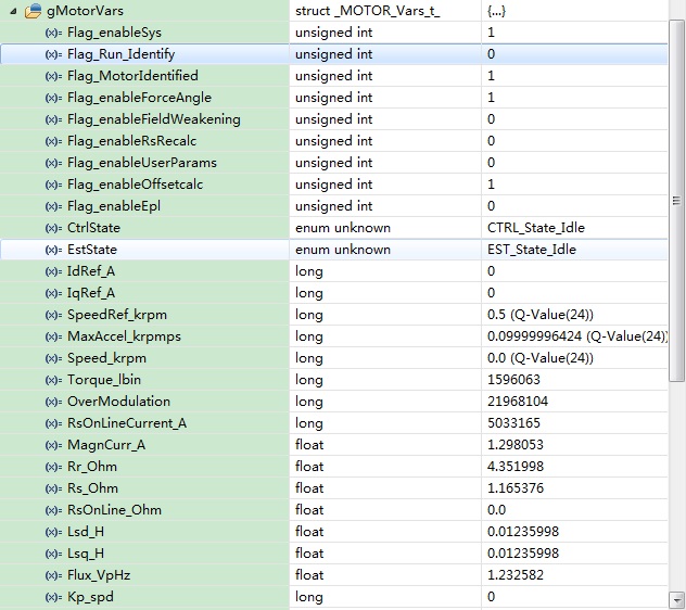

     the result is follow:
                                                                        Figure3  Using default waittime values

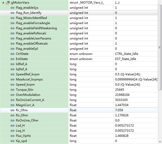

    when i chage the default waittime using my waittime value,
                                                                        Figure4  change default waittime values
    2:as above when i change the waittime,the driving effect is better than the default value,why?

    I haven't done the math on your circuit, just want to make sure that you have and 178.0059 is correct.  You run your bus at 80V and have 178V scaling though?  That's not ideal. Any reason you choose 178?
    FULL_SCALE_CURRENT_A
    Why do you have the same values as the HVKit. Did you keep the exact same current shunt and sense values with no changes?  It's fine for your 5A motor, but you could have adjusted this even further.

    #define USER_VOLTAGE_FILTER_POLE_Hz  (318.0)
    Again, haven't done the math on your circuit, just want to make sure you have

    3:FULL_SCALE_CURRENT_A   This value is the same as HVKIT,because the current sample circuit is the same as HVKIT,such as resistance and operational amplifier and gain,so I don't have to change these values?

  • why 1.5V/Hz?
    In your screen shot the Flux_VpHz value is ~1.5.  Multiply this by your highest frequency and this is the Bemf voltage the motor will be producing.
    Ok.
