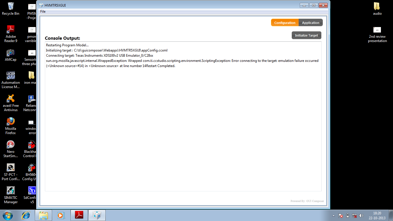

unable to communicate the kit with PMSM motor .error code 14 came
Other Parts Discussed in Thread: TMS320F28055, CCSTUDIO, CONTROLSUITE, MOTORWARE
We cant able piccolo controller f2805x with PMSM motor .error code 14 will appear during the communication .
    Can you attach a screenshot?

  • you don't need to change the emulator connection.
    The error says that you aren't reaching the emulator on the controlCARD, so you need to re-check your settings per the guide.
    - USB connection from PC to controlCARD. Make sure that the USB connection to XDS100 is showing up in your PC Device Manager
    - Power to the controlCARD. This typically comes from the 15V supply, but may come from the high voltage bus depending on your jumper and banana cable settings

  • The XDS version of the F28055ISO controlCARD is XDS100v2
    Yes, you can use any CCStudio to connect. I believe the 5x device was only added in CCSv5 though, so I recommend just installing latest CCSv5.5 from the download site.
    In there you can create a Target Configuration for XDS100v2 and TMS320F28055
    You can launch that connection, connect, and try to load
    C:\ti\controlSUITE\development_kits\TMDSHVMTRKIT5X_v1.0\~GUI\HVMTRKIT5XGUI\appProgram.out
    this is the .out that the GUI tries to load when you launch the .exe
    The GUI .exe is just doing the same thing that you manually do in CCS:
    Launch Emulation Configuration
    Connect Target
    Load .out
    Turn on Real-Time emulation
    Run the program
    If you can do these steps in CCS the GUI should be able to do the same thing...

    c. [Main]-J9 and [M3]-J5 are not populated.
    As I know, to use USB JTAG from ControlCard, you should:
    Insert jumper [M3]-J5
    Remove jumper [Main]-J9
    (JTAG connection will occur via USB connector on controlCARD)
    SW4 position 1 of the ControlCard should be ON.
    Please check these setting and try again to open your GUI.
    Good luck!
    Maria
  • Maria,
    Good catch!
    yes, per all the QSGs (GUI & HVKIT), when using an ISO/JTAG controlCARD you need to POPULATE M3-J5 to turn off the emulation from the HVKIT to the DIMM interface.

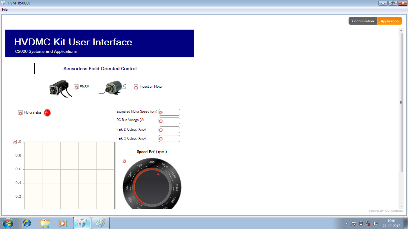

    I  change the Switch SW 4 to On  position  .I kept the jumper J5 and J9 in open position. I take the trail through GUI ,its communicated and motor also running based on the reference value  .I dont know this is correct or not .
    And During running we got some value for Park Q and Park D but we dont get value for Extemated Motor Speed . Ext speed curve always shows Zero .
    Also i need to mention one thing , I runned  the motor for just 3 Minutes in 600 RPM but the motor got exterm high temperature .
     Please support

  • Maria, my kit name is TMDXHVMTRKIT5X .i got the gui software along with kit ang gui name is HVMTR5XGUI. Motor is Pmsm motor and make is estun .EMJ-04APB22. Jumper setting.-main J3 J4 J5 are populated main j2 is populated between bridge and middle pin . dc bus voltage reachrd upto 277. Volt please support .i have only 5 hours .i need to present to my officers . please

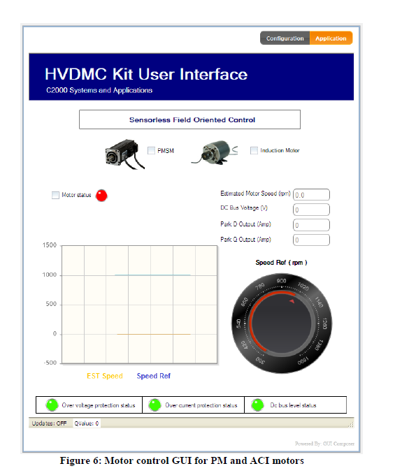

    I think DC Bus Voltage 277 V looks fine.
    Can you send the screenshot of the GUI while your motor is running?
    Maria
  • Maria,
           Thank you soo much for your great  support . I sucessfully run the Kit based on your input and support .
    I reduced speed reference from 1000 to  600 RPM then the  extemated value graph came  .If the speed reference the increased  above 700 RPM .,the DC bus voltage fault will occure .for that reason only it not shows the extemated value .
