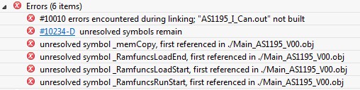

When I want to do a flash boot with my project, I'm having building errors.
I don't know how to sort them out (it's the first time i'm using a C2000).
Below, you will find what I have already done :
1) In the properties of CCS, I had the predifined symbol "FLASH"
2) I had "CodeStartBranch.asm" in my project
3) I modified the original linker command file (please see it attached .txt instead of .cmd)
4) GPIO34 (boot PIN) and GPIO37 (TDO) are both high to boot on FLASH
Your help would be very appreciated.
  • Hi!
    1 Check please that you defined the following in your main.c file:
    #ifdef FLASH
    // Used for running BackGround in flash, and ISR in RAM
    extern uint16_t *RamfuncsLoadStart, *RamfuncsLoadEnd, *RamfuncsRunStart;
    #endif
    2 Also try to edit your cmd-file thus:
    ramfuncs : LOAD = FLASH_ABCDEFGH,
    RUN = RAMM0,
    LOAD_START(RamfuncsLoadStart),
    LOAD_SIZE(RamfuncsLoadEnd),
    RUN_START(RamfuncsRunStart),
    PAGE = 0
    3 I would recommend you to download motorware package. This will help you.
    Igor

  • Hi Sebastien!
    BTW regarding unresolved symbol "memCopy". This function (in two versions) is defined here
    ti\MotorWare\MotorWare_1_01_00_09\sw\modules\memCopy\src\.
    Perhaps one should include to project .h & .c files where this function is defined.
    Igor
    Maybe you should put too another .cmd file that you can find in C:\ti\motorware\MotorWare_1_01_00_09\sw\ide\ccs\cmd (in my case I use Headers_nonBIOS.cmd).
    So it will be 2 cmds in your project.
    In my case for motorware project:
    1. I added memCopy.c (Igor has told you where it can be found)
    2. I added F28069F.cmd and F2806x_Headers_nonBIOS.cmd
    3. I removed F28069F_ram_lnk.cmd
    4. I defined FLASH in project properties
    5. I added CodeStartBranch.asm
    6. I checked whether flash has been setup (initialize) in the code or not
    7. I set the boot switch in my controlcard to be flash boot mode
    That's all. Hope it works for you.
    Maria
    Thanks Maria and Igor.
    I'm one step further...
    I had to add memCopy.c in my project and I had to add the "_" at the beginning of RamfuncsLoadStart, RamfuncsLoadEnd and RamfuncsRunStart.
    secureRamFuncs     :
    LOAD = FLASH_ABCDEFGH, PAGE = 0                // Used by file Flash.c
    RUN = RAML0_L3,        PAGE = 0                // Load to flash, run from CSM secure RAM
    LOAD_START(_RamfuncsLoadStart),
    LOAD_SIZE(_RamfuncsLoadEnd),
    RUN_START(_RamfuncsRunStart)
    As a result, 0 error and 0 warning.

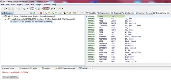

    When I pressed on debug button, I saw erasing flash process and I think loading flash (I was very fast).
    After that I pressed on "Enable silicon real time mode" button and finally I pressed on "Resume" button and the MCU is blocked like the picture below :
    What's wrong?

  • Hello Maria and Igor,
    Thanks, I was able to add a new cmd file.
    Do you have an idea about the fact that the MCU is blocked at the address 0x3ff4fa?

    Thanks for your answer Jeff.
    I read these labs and the labs 2b explain how to use speed and current controller in RAM and FLASH instead of ROM but not how to boot the application from FLASH for a stand alone device.
    Igor, I'm using TMS320F28062F and as you saw, I modified F28062F_ram_lnk.cmd and I added F2806x_Headers_nonBIOS.cmd.
    It seems that the MCU is blocked (address 0x3FF4FA) in "Bootloader function" (address 0x3FF3B0 to 0x3FF7D2).
  • Hello Sebastien,
    I am not sure what you call in your code.
    In your cmd file that you attached, they were 2 ramfuncs.
          ramfuncs : > RAMM0, PAGE = 0
          secureRamFuncs :
                        RUN = L4SARAM, PAGE = 0 // Load to flash, run from CSM secure RAM
    In your case, in the beginning you should define like this (for example: for mainISR):
    #ifdef FLASH
    #pragma CODE_SECTION(mainISR,"secureRamfuncs"); // make sure you call secureRamfuncs instead of ramfuncs
    #endif
    Then you should make sure that you call memCopy() like this.
    memCopy((uint16_t *) &RamfuncsLoadStart, (uint16_t *) &RamfuncsLoadEnd, (uint16_t *) &RamfuncsRunStart);
    And in your cmd file, your should define like this:
    secureRamfuncs :
                       RUN = RAML0_L3,
                       LOAD_END(_RamfuncsLoadEnd),
                       RUN_START(_RamfuncsRunStart),
                       LOAD_SIZE(_RamfuncsLoadSize),
                       PAGE = 0
    Please notice that LOAD_SIZE and LOAD_END are different.
    And memCopy calls LOAD_END (not LOAD_SIZE).
    If you have checked this and still have the same error, maybe you should check your Debug setting. I am not sure what the correct settings are. In my case I just used the default setting.
    And indeed, it is better you try the example from TI first before going to your own code.
    Hope you can solve your problem soon.
    Maria
  • Sebastien,
    I see. Nonetheless I suspect the problem is into your modified file .cmd. Maybe the best way is take for base F28069F.cmd from motorware package and to modify one according memory map of F28062. Or migt take F28062.cmd from ti\controlSUITE\device_support\f2806x\v136\F2806x_common\cmd\ and to modify it in part of ramfuncs section.
    Igor
  • Igor, Maria,
    It works now :-)
    You were right Igor, I had a problem in my cmd file. The address and size of the flash memory were for F28069 instead of F28062. My project is better now, with a F28062F.cmd + F2806x_Headers_nonBIOS.cmd.
    Thanks a lot for your help.
