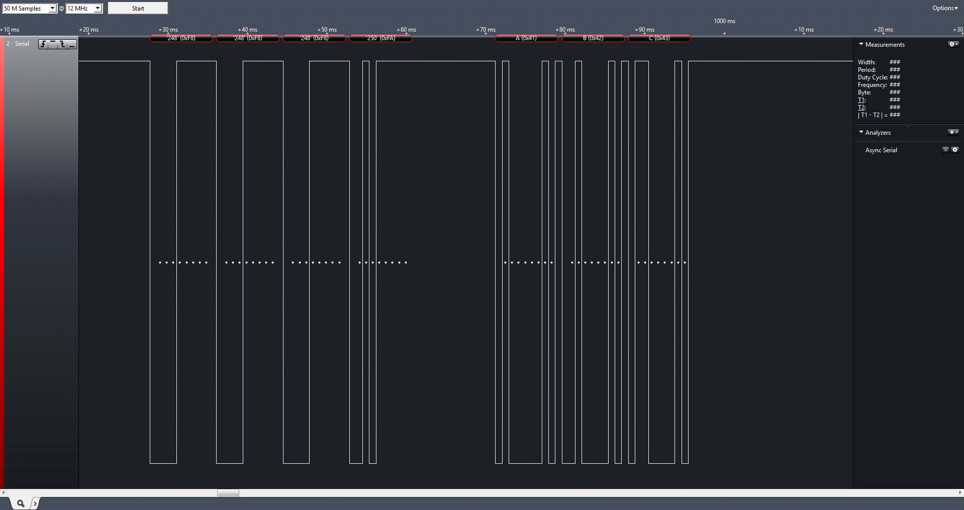

Hi all
Ive been trying to wrap my head around the C2000 Piccolo demoboard pretty powerful stuff very impressed.
Question 1:  is how do i measure a signal clock on a GPIO and get the period (in my case im scanning for 10ms high edge to indicate the start of a data packet,
Question 2: How would i get the data bits if the period is 1.66ms high pulse=0.8ms low pulse=0.8ms how do i detect the data bits? I tried using a timer but I just failed to get it working.
I'm getting data packets from the RF receiver and intercepting the rising and falling edges via an on change interrupt  vie tried to look at the CPU timer0 and some examples but unfortunately it was of very little help as it deals with measuring intervals using timer interrupts.
please help
This is the code, ive simplified it so its easy to read.

interrupt void xint1_isr(void)
    // check data
    check_data();
    // Toggle GPIO-6
    GPIO_toggle(myGpio, GPIO_Number_0);
    GPIO_toggle(myGpio, GPIO_Number_6);
    // Acknowledge this interrupt to get more from group 1
    PIE_clearInt(myPie, PIE_GroupNumber_1);
void check_data(void)
    // Detect pulse falling edge on the GPIO port-12.
    if( GPIO_getData(myGpio, GPIO_Number_12) == 0 ){
    // Detect pulse rising edge on the GPIO port-12.
    if ( GPIO_getData(myGpio, GPIO_Number_12) == 1 ) {
