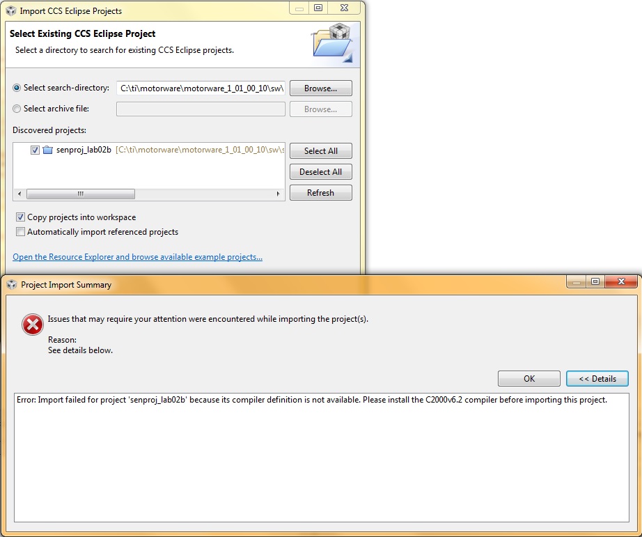

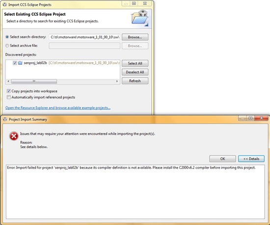

  • Hello Chris,
    Until now, I am still using CCSv5.4 and compiler 6.1.
    When I wanted to import instaSpin-FOC f2802xF project from motorware v10 to CCSv5.4,
    I found that it could not be imported if I didn't have compiler 6.2.
    But even when I already installed ti_cgt_c2000_6.2.3_setup_win32.exe, the problem was the same.
    I corrected it. After I added the compiler to CCSv5.4, the project could be imported.
    But in this case, we have to note: we need to install new compiler 6.2 first!
    Maria
  • Glad you solved. I wish we didn't update CCS and compiler so frequently, it really adds unnecessary complication.
