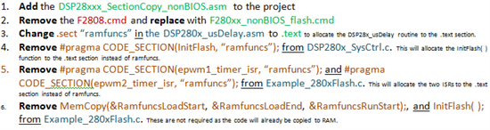

Hello everyone. I’m developing an application in Matlab-Simulink (2013a) with Embedded-Coder to run on a TMS32028335. The workflow is working fine with the makefile method which generates an .out file I can directly load into CCSv5.
I’m quite tight on processng time and therefore need to enhance the performance by executing from RAM (I have measured about 40% longer cycle times on Flash). Therefore I tried to implement the method described in SPRAAU8. Memory consumption of both Flash and RAM is reasonably low (and could be further optimized) so this should be no problem.
My problem is that I can’t get it to run, although everything seems to be in its place. Following I describe the steps I take (following SPRAAU8) to implement the copy to RAM method:

    Also, should this be helpful, here are the steps from SPRAAU8 summarized by me to be more overviewable:
  • Hi Martin,
    The doc SPRAAU8 worked like gem since day one. So I don't think there's any issue with the doc.
    Gautam

  • Hello Gautman,
    thanks for your reply. Yet, as I have been commenting in this thread where Tim Love himself uploaded the modified version of the .asm routine, I'm a bit confused about the implications of these modifications.
    In any case, as I commented there but should be discussed here, my application remains not working even with Tim's modifications, so unfortunately there must be something else wrong. I would be very grateful if someone could have a look and maybe identify what is broken 6170.test3mod.zip . Do my steps descibed above seem wrong or could smething else be failing?
    Thanks!
    Martin
