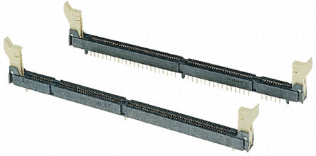

  • No it isn't my own board, it is a TI EVM
    I have a C2000 Microcontroller Card (tms320f2808) , mounted on a Docking Station, and they get their power supply from the USB,....
    I have a Code Studio Composer V5, the C/C++ headers for the DSP280x.......,
    Do I need to install something (like Firmware) before using the Control Card.
    Forat

  • Forat,
    Perhaps you have something wrong with your ControlCard.  Maybe the GPIO14 output buffer is damaged.  Everything works fine for me on my F2808 Control Card.  Attached is a simple CCSv5.5 project that will blink LED 2 and 3 (GPIO31 and 34) and also toggle GPIO14, all at a 2 Hz rate.  You need CCSv5.5 (or later) to load the project into CCS.  Older CCS versions will usually not load newer projects.  If you don't have CCSv5.5, you can always just make a new project and dump my source files into it.
    If it still doesn't work, try a different pin than GPIO14.
    - David

    Yes that is the docking station I am using.
    I am using testing on Pin 8 because on the tms320f2808 datasheet, pin 8 corresponds to GPIO14, and I thought each pin in the docking station matches the pin in the tms320f2808 Control Card.
    I tested the Voltage value using a digital oscilloscope from the pin of interest (pin 8) with reference to the ground in the docking station.
    I presume that what you mean by DIMM socket is the 5V power adapter that comes with. I don't have it, when I bought it online they (rs-components) didn't supply with one. I tried to use another 5V power adapter, but there the green POWER LED is not lit.
    I found out what DIMM socket means
    I tested the pins at the back of the DIMM socket, some of them gave me 3.3 V, some gave me 5V and some gave me 0V, but I don't know which pin on the socket corresponds to which pin/GPIO
    PN: I tried to test the voltage at pin 84 with the same last program I provided and still there are no results

  • I did find where the fault is, the docking station are not numbered after the pins, but there is 35 GPIO pins that corresponds to 35 tms320f2808 microprocessor pins.
    Hence GPIO14 corresponds to pin 14.
    So Thank you everyone for your help and support
