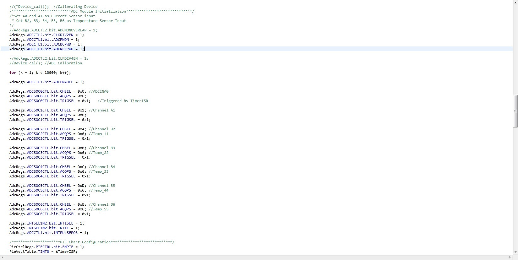

I am programming a TMS320F28069 microcontroller with several ADC channels enabled. There are seven SOCs under utilization, corresponding to ADCINA0, A1, B2, B3, B4, B5, and B6.

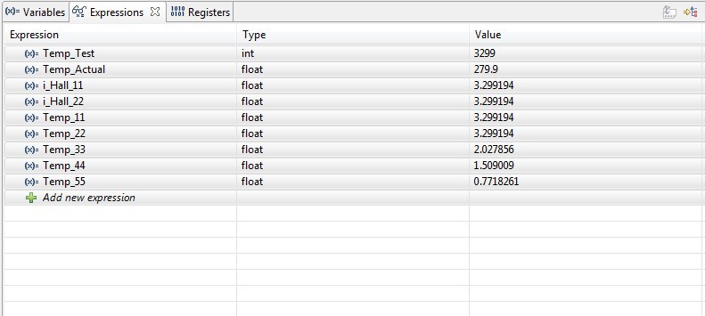

Attached with my configuration (Picture #1) and the result I have under debug mode (Picture #2).
As shown in Picture #2, there are three unstable results came from SOC4, SOC5, and SOC6. Apart from those three, the rest are extremely close to 3.3V (no load).
I am still learning, and this is beyond my knowledge and experience at this moment. It would be great if anybody could give some advice.

    Shown in picture is my ADC subroutine. The ADC fetches data whenever enters the subroutine. Thanks!
  • Hi, I also want to know what kind of  inputs are these ADCs fed? or are they left floating?

  • Frederick,
    It looks like you are triggering your ADC ISR after EOC1, which means that SOCs 2-6 have not finished converting when your ISR is triggered.  Can you try to change the INTSEL to EOC6?

  • Two of them are fed by Hall Effect current sensors, and five of them are fed by temperature sensors (Analog Devices TMP36GZ). The three channels assigned to temperature sensors were getting unstable data. Thanks!

    By following your suggestion, I changed
    AdcRegs.INTSEL1N2.bit.INT1SEL from 1 to 6. Yet the unstable channels were still having the same issue.
    I enabled "Continuous Refresh" function in CCS in order to trace voltages changing, and I realized that values come out of those three channels are continuous updating rather than stay at some certain level.

  • Fred,
    Can you scope the F28069 ADC pins while they are sampling the temperature sensors?  You may need to buffer the the temperature sensor signals if you see disturbances during S/H switching.  You can also try to max out the ACQPS values to see if the readings improve.
    -Tommy
  • Tommy,
    Whenever any pin is connected to the Oscilloscope, the reading changes to 0 instantly. When disconnecting that pin from the Oscilloscope, the reading goes back to whatever it used to be.
    I changed INTSEL to 6, and maxed ACQPS to 3F. It seems like the readings are reasonable on those unstable pins, when being fed by the temperature sensor. Although they returned to unstable after disconnecting temperature sensors.
    There is a margin of approximately 1 degree celsius of reading between stable and unstable pins. If I am averaging them, the difference could be ignored. I think this is the best solution so far.
    Thank you for your time and your suggestions!
