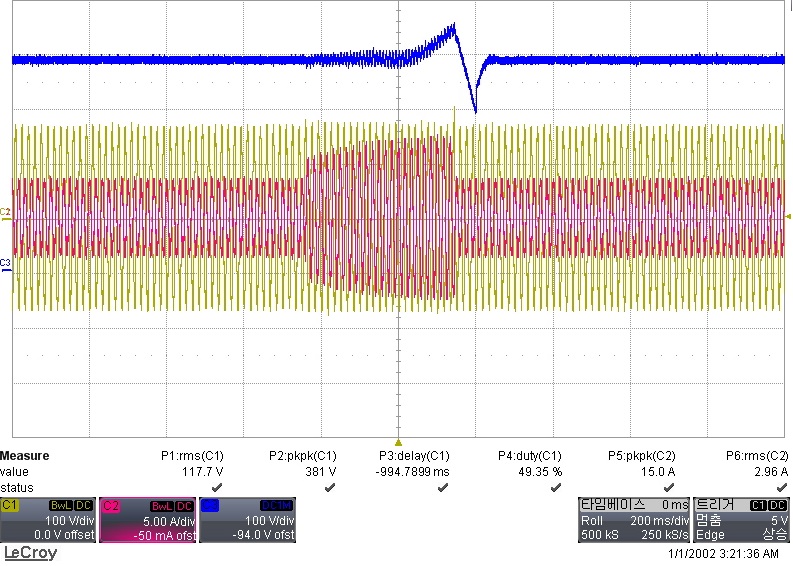

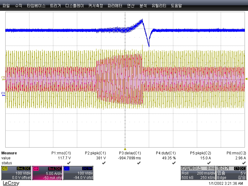

I'm testing gried-tie inverter using TMDSHV1PHINVKIT.
DC input source is 380Vdc in CV mode.
I want that EVM is operated only grid-tie DC to AC inverter. My application is not solar.
When I connected the EVM to grid (120V/60Hz) for Grid-Tie Operation, DC bus voltage is increased and system enters fault mode.
DA-AC Running Information shows "DC Bus Over"

  • Hi Maria,
    I didn't change and download on flash memory of control card (F28035).
    I will try to test as you suggested and I have a question.
    The SW of control card is applied Closed Loop Build with PLL. (INCR_BUILD = 3)
    When Inverter starts operation, AC output and DC Bus voltage increases.
    And then stopped when voltage of DC bus is over.
    I don't understand why DC bus is increased when AC grid is connected.
