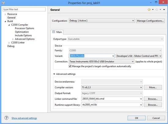

I have already installed all updates to Code Composer Studio 5.5.0 (and am using 5.5.0) , which eliminated an initial compiler warning.
See my build configurations:

    InstaSPIN-FOC is only available on 2806xF and 2802xF, and InstaSPIN-MOTION only available on 2806xM. So no 28035 device has InstaSPIN-FOC or MOTION in ROM.
    I just built these two projects with no issues:
    motorware_1_01_00_10\sw\solutions\instaspin_foc\boards\drv8301kit_revD\f28x\f2806xF\projects\ccs5\proj_lab01
    motorware_1_01_00_10\sw\solutions\instaspin_foc\boards\drv8301kit_revD\f28x\f2802xF\projects\ccs5\proj_lab01
    If you need to run the GUI that comes with InstaSPIN-FOC or InstaSPIN-MOTION, you need to get a 2806xM control card, which is available here:
    http://www.ti.com/tool/TMDSCNCD28069MISO
    -Jorge
