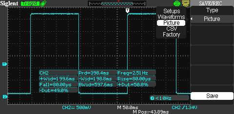

I need some assistance with trying calculate period using the “ecap” module.
I put an example together that generates an interrupt every 5Hz with a duty cycle of 50% I then feed that square wave running at 5hz back into the board to the ecap module and "attempt" to verify the period. I was able to setup the ecap module im able to hit breakpoints using the ecap ISR
My Question is :

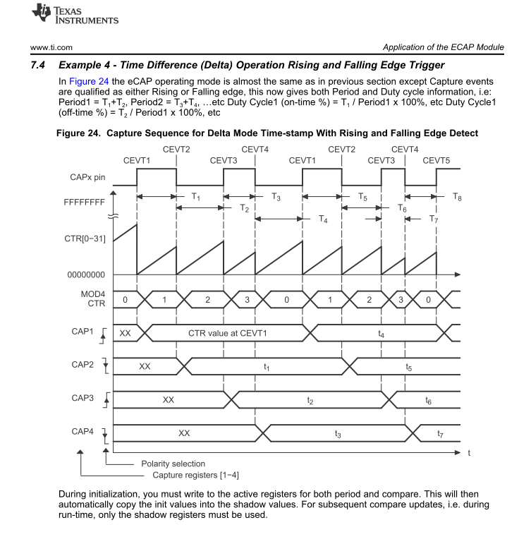

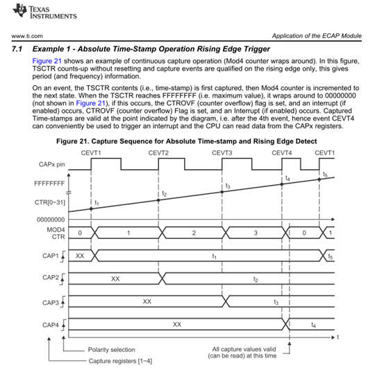

I’m confused just how to calculate the period I have setup CPU to run at 50mhz and I understand the capture counter cycles down until the programmed pulse edge is detected as stated in the datasheet but still no luck get my calculation right…
Ive been reading the datasheet on this subject for days but no luck.
http://www.ti.com/lit/ug/sprufz8a/sprufz8a.pdf

  • Yaghiyah,
    I did not read through your code but you can follow example 3 on page 29 of the ECAP Reference Guide (http://www.ti.com/lit/ug/sprufz8a/sprufz8a.pdf), to set up a Delta operation for the ECAP module.  You then will have the period counts which you can divide by your operating frequency (50MHz in this case).

  • Hello Yaghiyah,
    Maybe you only did small mistake in this line.
    Yaghiyah Brenner said:
    CAP_enableInt(myCap, CAP_Int_Type_CEVT4);
    I think CAP_Int_Type_CEVT4 should be CAP_Int_Type_CEVT2?

  • Hi all
    I think I have the result I need.
    Fig 1 shows the timer generating a period of ~ 400ms / 2.5 Hz @ 50% duty cycle as shown.
    As suggested, I was not using the correct ecap setup, I used a counter that did NOT reset the counter to zero giving me random numbers and strange results (no wonder I didn’t understand it and Im trying to understand more of this )
    Below is the configuration I used as suggested a delta timing I only used one capture register to sample period.
    See Fig 2
    The code looks like this... I simplified  it for readability.

    My result looks like this using the capture 1 register I get a counter of 20000013 from the "time stamp" counter. with my CPU clock running at 50Mhz .
    TIME_STAMP = CAP_getCap1(myCap);
    Period = ( SYS_CLOCK  /  TIME_STAMP)
    Period = (50 000 000 /  20000013 )
    Period = 2.499 OR 2.5 Hz.
    I got 2.4999 Hz (2.5Hz) proving the result from the scope.
    I think the next challange is to learn the "time difference delta" to calculate duty cycle..
