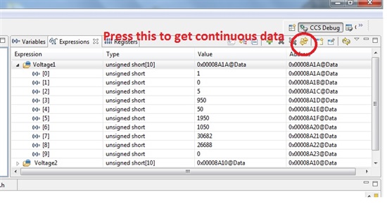

  • HI,
    If the ADC is reading or not, I do not know.
    Check the reading on the watch window and try to plot a graph.
    Gautam

  • Hi Gautam
    In the watch window the ADC has zero value.
    In the graph, nothing appears.
    Does the ADC is performing only one reading?

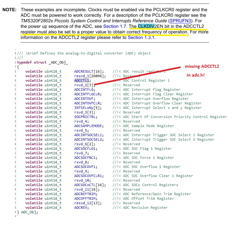

  • Hello Patrick,
    I think I found what it is wrong in ADC of F28027.
    I really hope it is the problem.
    In adc.h, ADCCTL2 definition is missing. And the fact we need it to set up CLKDIV bit.
    So I attach the modification files here.
    2742.adc-f28027.zip
    The modifications are:
    ADC.H
    //! \brief Defines the location of the CLKDIV2EN bits in the ADCTL2 register
    #define ADC_ADCCTL2_CLKDIV2EN_BITS         (1 << 0)
    //! \brief Defines the location of the ADCNONOVERLAP bits in the ADCTL2 register
    #define ADC_ADCCTL2_ADCNONOVERLAP_BITS      (1 << 1)
    //! \brief Defines the analog-to-digital converter (ADC) object
    typedef struct _ADC_Obj_
        volatile uint16_t      ADCRESULT[16];    //!< ADC result registers
        volatile uint16_t      resvd_1[26096];   //!< Reserved
        volatile uint16_t      ADCCTL1;          //!< ADC Control Register 1
        volatile uint16_t      ADCCTL2;
        //volatile uint16_t      rsvd_2[3];        //!< Reserved
        volatile uint16_t      rsvd_2[2];        //!< Reserved
        volatile uint16_t      ADCINTFLG;        //!< ADC Interrupt Flag Register
        volatile uint16_t      ADCINTFLGCLR;     //!< ADC Interrupt Flag Clear Register
        volatile uint16_t      ADCINTOVF;        //!< ADC Interrupt Overflow Register
        volatile uint16_t      ADCINTOVFCLR;     //!< ADC Interrupt Overflow Clear Register
        volatile uint16_t      INTSELxNy[5];     //!< ADC Interrupt Select x and y Register
        volatile uint16_t      rsvd_3[3];        //!< Reserved
        volatile uint16_t      SOCPRICTRL;       //!< ADC Start Of Conversion Priority Control Register
        volatile uint16_t      rsvd_4;           //!< Reserved
        volatile uint16_t      ADCSAMPLEMODE;    //!< ADC Sample Mode Register
        volatile uint16_t      rsvd_5;           //!< Reserved
        volatile uint16_t      ADCINTSOCSEL1;    //!< ADC Interrupt Trigger SOC Select 1 Register
        volatile uint16_t      ADCINTSOCSEL2;    //!< ADC Interrupt Trigger SOC Select 2 Register
        volatile uint16_t      rsvd_6[2];        //!< Reserved
        volatile uint16_t      ADCSOCFLG1;       //!< ADC SOC Flag 1 Register
        volatile uint16_t      rsvd_7;           //!< Reserved
        volatile uint16_t      ADCSOCFRC1;       //!< ADC SOC Force 1 Register
        volatile uint16_t      rsvd_8;           //!< Reserved
        volatile uint16_t      ADCSOCOVF1;       //!< ADC SOC Overflow 1 Register
        volatile uint16_t      rsvd_9;           //!< Reserved
        volatile uint16_t      ADCSOCOVFCLR1;    //!< ADC SOC Overflow Clear 1 Register
        volatile uint16_t      rsvd_10;          //!< Reserved
        volatile uint16_t      ADCSOCxCTL[16];   //!< ADC SOCx Control Registers
        volatile uint16_t      rsvd_11[16];      //!< Reserved
        volatile uint16_t      ADCREFTRIM;       //!< ADC Reference/Gain Trim Register
        volatile uint16_t      ADCOFFTRIM;       //!< ADC Offset Trim Register
        volatile uint16_t      resvd_12[13];     //!< Reserved
        volatile uint16_t      ADCREV;           //!< ADC Revision Register
    } ADC_Obj;
    //! \brief Enumeration to define the start of conversion (SOC) numbers
    typedef enum
      ADC_DivideSelect_ClkIn_by_1=0,                     //!< Denotes Main Clock Prescaling of 0
      ADC_DivideSelect_ClkIn_by_2=1                      //!< Denotes Main Clock Prescaling of 2
    } ADC_DivideSelect_e;
    //! \brief     Enables no overlap mode
    //! \param[in] adcHandle  The analog-to-digital converter (ADC) object handle
    void ADC_enableNoOverlapMode(ADC_Handle adcHandle);
    //! \brief     Sets the analog-to-digital converter (ADC) divide select value
    //! \param[in] divSelect    The scale reference source
    void ADC_setDivideSelect(ADC_Handle adcHandle,const ADC_DivideSelect_e divSelect);
    ADC.C
      ADC_Obj *adc = (ADC_Obj *)adcHandle;
      ENABLE_PROTECTED_REGISTER_WRITE_MODE;
      // set the bits
      adc->ADCCTL2 |= ADC_ADCCTL2_ADCNONOVERLAP_BITS;
      DISABLE_PROTECTED_REGISTER_WRITE_MODE;
      return;
    } // end of ADC_enableNoOverlapMode() function
      // clear the bits
      adc->ADCCTL2 &= (~(ADC_ADCCTL2_CLKDIV2EN_BITS));
      // set the bits
      adc->ADCCTL2 |= divSelect;
      return;
    } // end of ADC_setDivideSelect() function
    EXAMPLE_2802xAdcSoc.C
        ADC_setDivideSelect(myAdc, ADC_DivideSelect_ClkIn_by_2); // put it in initialization, before main loop
    Please replace adc.h, adc.c, and example_2802xAdcSoc.c files using the ones that I send.
    Please try it (by connected to GND or VDD) and let us know the result.
    You can use ADC_enableNoOverlapMode also to avoid overlap sample.
    Maria

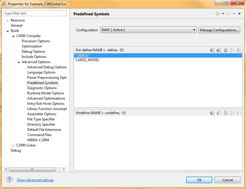

  • Hello Patrick,
    For eliminate that warning, you can define _DEBUG in the project properties.

  • One thing I want to ask:
    Did you press this button below ?
    This button is used to get continuous data (refresh the data) while debugging.
    Maria

    I don't have any problem at all and everything is fine. I got Voltage1 and Voltage2 as they should be.
    So it was really strange that in your case you had to pass the hard way.

    You did not need to use the command: CLK_enableTbClockSync (myClk)?
  • Hello Patrick,
    I just noticed that this line CLK_enableTbClockSync(myClk) is already there in the example code.
    I downloaded and used the latest ControlSuite (v3.2.4). But as I remember, in previous ControlSuite (when we tried to figure out the problem), this line was missing. So seems that TI just fixed them.
    I suggest you to use the latest one too.
    When I disabled this line CLK_enableTbClockSync(myClk), the results were really random.
    So indeed we need CLK_enableTbClockSync(myClk).
    And I think the CCS v5.3 is not the problem.
    Maria

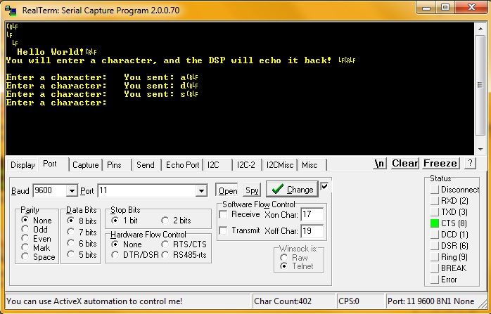

    i am trying to learn Serial communication. I used the example "sci_echoback"
    but the program doesn't work. I installed the Hercules for view and doesn't transmit or receive.
    Follow the code from example;
    Is this code missing anything?

  • Hello Patrick,
    In the launchpad-F28027, you should switch S4 (Serial) up (ON).
    And in the PC terminal, you should set the baud rate as 115200, no parity, one stop bit.
    I will try this example too and let you know the result.
    Maria
  • Hello again,
    I have tried this example code to launchxl-F28027F: C:\ti\controlSUITE\device_support\f2802x\v210\f2802x_examples\sci_echoback
    and it works well. You can see the result in this picture below.
    I use RealTerm in this case but it doesn't matter what your serial terminal is.
    You should configure the port. In this example code, the configuration is 9600 baud rate, no parity, 8bits data, 1 stop bit. And the serial port is recognized as COM port 11.
    And don't forget the switch S4 (Serial) to be ON (up).
    Hope you can make it run too.
    Maria
